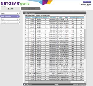

So a month or so back the Motorola modem from Xfinity just stopped working as Xfinity was "Working in the area to bring 10G to the region(DC/DMV)" Sent us a new X7 modem/wireless router combo and th...

Has the ISP made any changes on there part? Last year XF stopped supporting there 1Gb speed tier and changes to having a 800Mpbs and a 1.2Gb speed plans. The CM series modem would no be supporting of the 1.2Gb plan.
Power on the modem from the ISP is TOO HIGH LOW. Needs to be turned UP:
https://kb.netgear.com/24311/Power-level-guidelines-for-a-NETGEAR-cable-modem-router

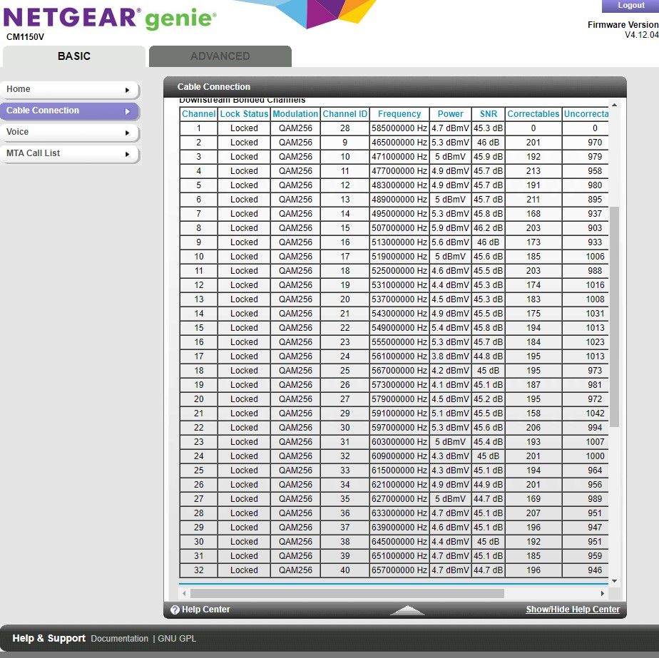

You have a ton of Correctables and Un-Correctables that should be zero.
Any Criticals, Errors or Warnings seen in the Event logs needs to be reviewed by the ISP and resolved. These indicate a signal issue on the ISP line up to the modem.
Have the ISP check the signal and line quality UP to the modem. Be sure the ISP provisions the modem correctly.

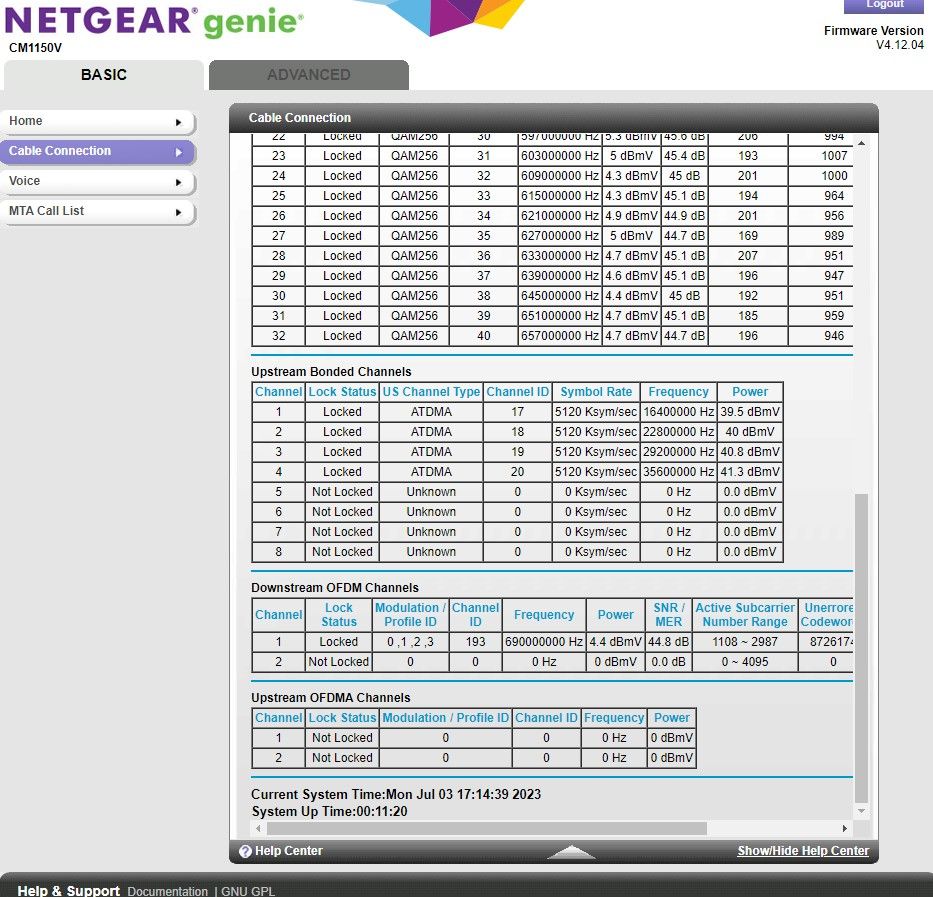

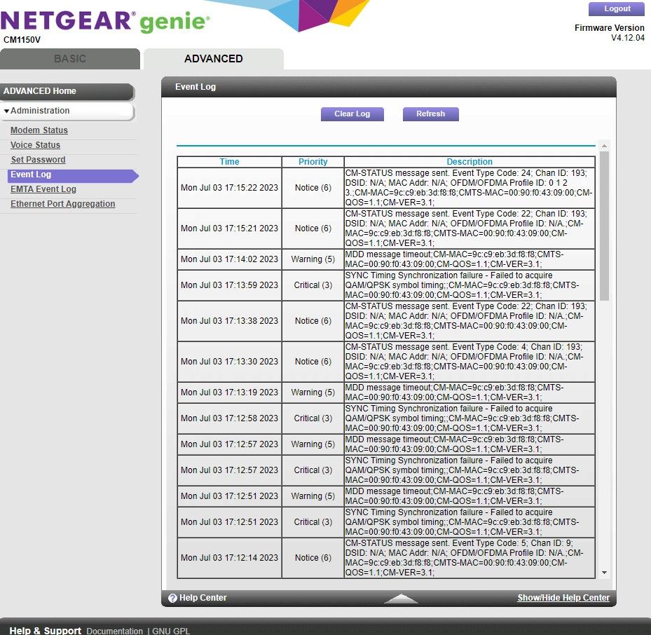

- panthrosanJul 03, 2023Aspirant
I ran a brand new Quad Shielded Cable from the outside connection straight to the Modem and now I am getting 45-46 DB Down and 39.5-41 DB Up so modem traffic looks good but still getting Critical "SYNC Timing Synchronization failure - Failed to acquire QAM/QPSK symbol timing" and Warning "MDD message timeout" in my event log and an unstable connection. Been on hold for 30 minutes waiting to talk to a human at Xfinity to ask them to ping the modem and tell them it 100% is on their end as it is a brand new Quad Shielded cable run from their termination to my brand new Modem.
