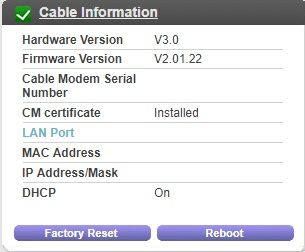

I took my router to my neighbors house who is on Spectrum (who is pushing the firmware updates), called tech support, told them I was my neighbor, told them I wanted to change my cable modem to my own (Netgear C6300), gave them the MAC Address, they turned it on, the upload and download lightning bolt looking arrows were flashing, that told me that the firmware was updating, to my neighbor out for Chinese food, came back, the lights were no longer flashing, inernet was up, checked my firmware version, and I am now on Hardware Version V3.0 Firmware Version V2.01.22. Called Spectrum back, told them I wanted to put my old router back on, gave them the MAC address of his original Router, and he was back up and running. Thank you Spectrum (I take back all the really bad things I said about you) and my patient neighbor!

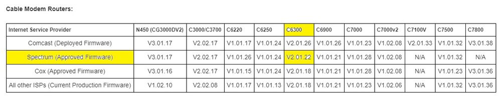

    It is not up to Netgear to allow firmware upgrades for cable modems this is all regulated by the cable companies they push the firmware for all cable modems when they believe it is needed. This applies to any brand of cable modem you own
