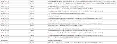

Note that I am receiving the following, apparently indicating an incorrect vendor config file:
- AudioDaveDec 25, 2023Aspirant
Also, connection directly to modem made no discernable difference. Power levels are the same, events are the same:
