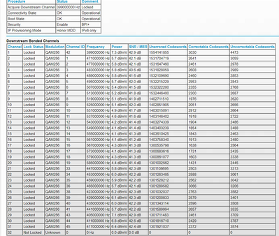

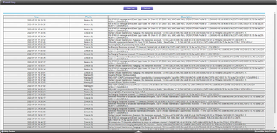

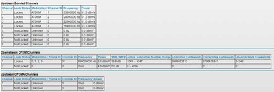

I have been having a lot of issues with my internet dropping randomly for 5secs to 15 minutes. This affects both wifi and wired and nothing reboots. -Xfinity is my ISP and have replaced the wir...

Power levels are a bit high but with in specs. Might check into a attenuator maybe.
However you have a ton of correct and un-correctables that should be zero's.
Need to check coax cabling and fittings. Remove any splitters and ensure fittings are snug and fit. No kinks and such in the cabling line.
B sure coax cable is of good quality RG6.
- MasterIBISJul 21, 2022AspirantOkay, I will and will report back. Thanks
