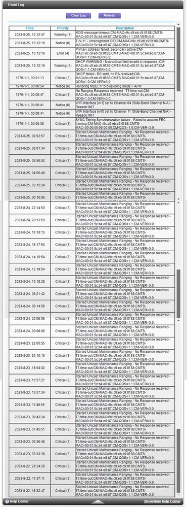

- pinkstonmsAug 25, 2023Tutor
- FURRYe38Aug 25, 2023Guru - Experienced User
Power levels are with in spec.
However you have some correctables and un-correctables that should be all zeros.
I see lots of Criticals and an Error in the Events logs. Any Criticals, Errors or Warnings seen in the event logs needs to be reviewed and resolved by the ISP. Indicates a signal issue on the ISP line up to the modem.
Have the ISP check the signal and line quality UP to the modem. Be sure the ISP provisions the modem correctly.
