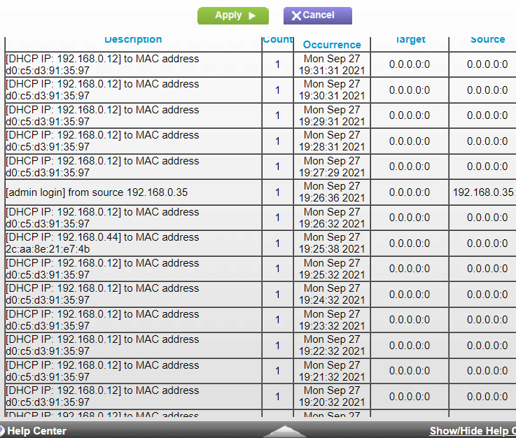

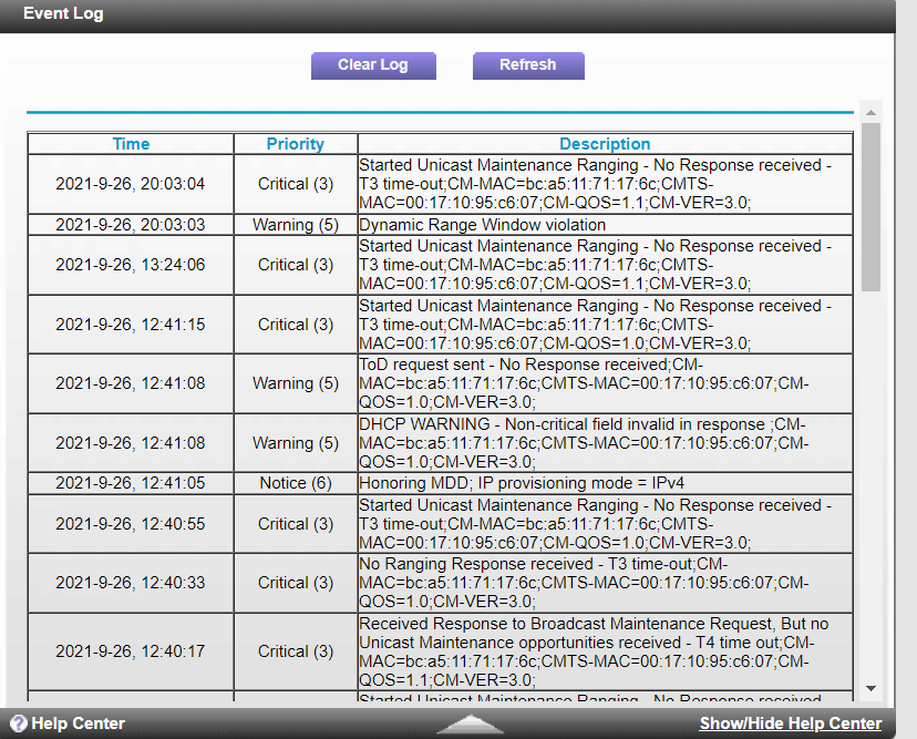

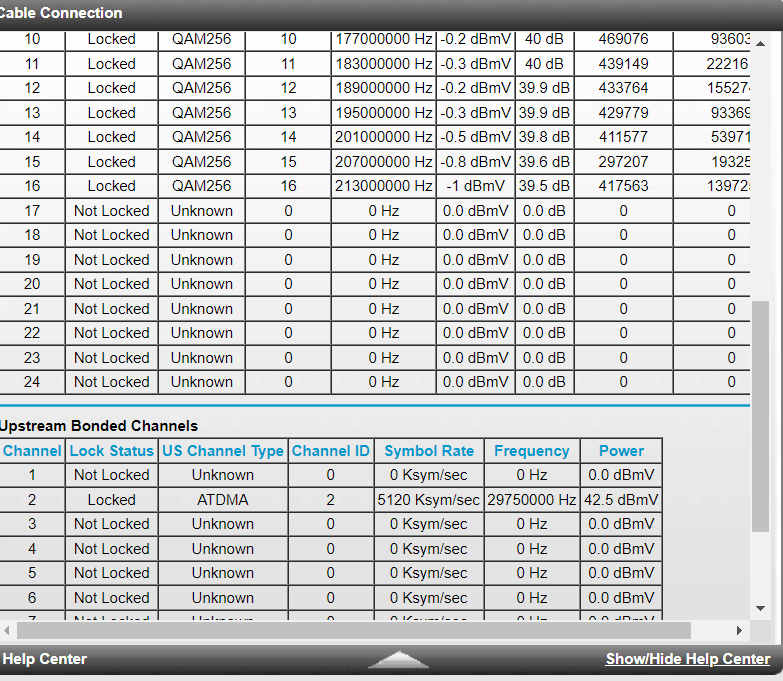

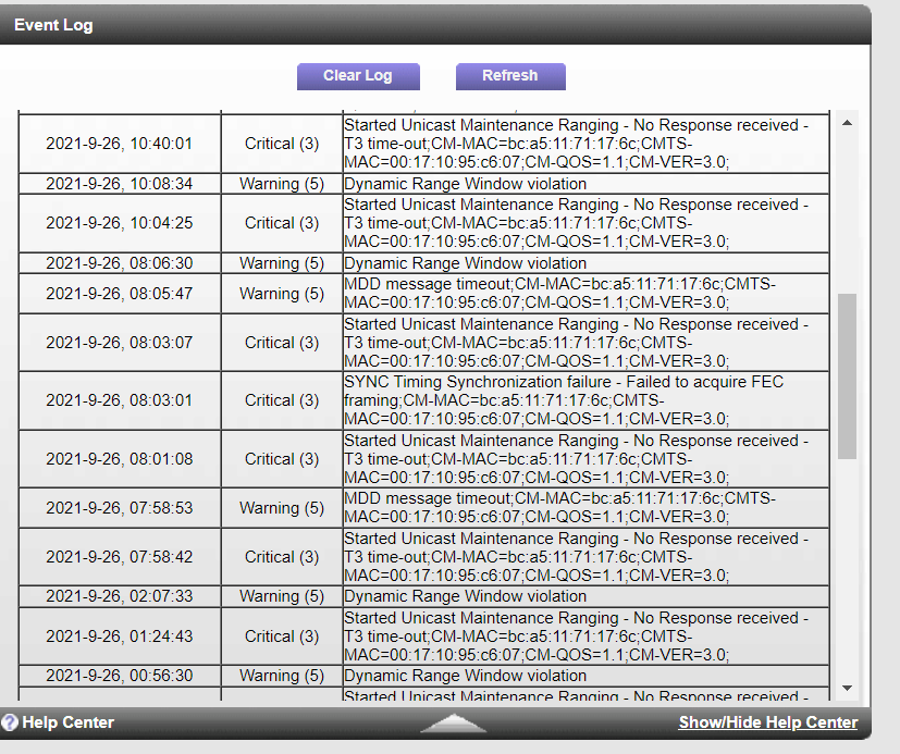

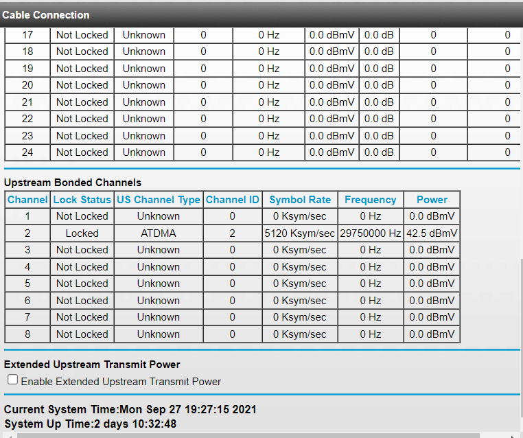

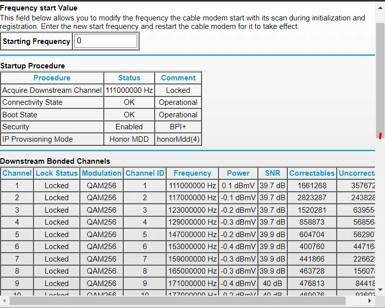

Sorry if this is bulky. I just learned what a snipping tool is. Sent emails earlier but they were returned. Hopefully this is the info you asked for.
Thanks for your help.
George Lawrence
I have been sending emails but all have been returned. Not sure if the attached photos will be present, as they are the logs you asked for.

to add them click on "choose file" and add them 1 at a time.
- retiredbgoSep 26, 2021Aspirant
I hope all the files are here. I hadded them one at a time. Thank you for your patience. This kind of stuff is ouit of my wheelhouse.
- plemansSep 27, 2021Guru - Experienced User
well you added 1 page of the "log"
Not the "event log"
Or the cable connections page.

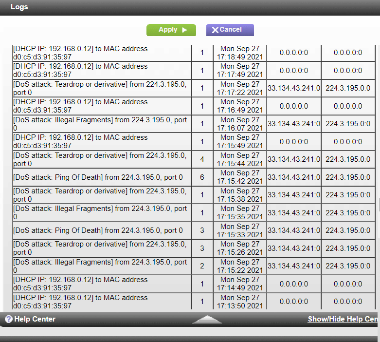

- retiredbgoSep 27, 2021Aspirant
I hope this finally goes thru. I noticed an log entry of (DoS attack: Teardrop or derivative] from 224.3.195.0, port 0) and not sure if this effects me. I have been running ok for the last two days. Thanks.
