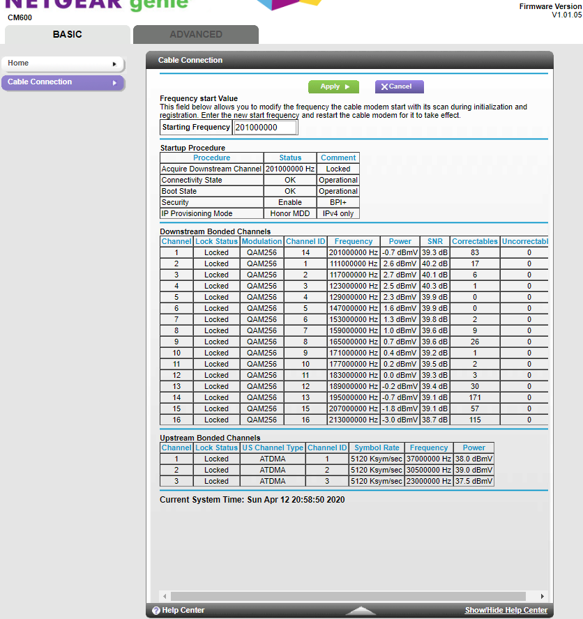

Yes. Last week I began experiencing so many drops that I couldn't productively work from home. I called my ISP, they said there wasn't a problem on their end and since I own my own equipment there was nothing else they can/will do. In addition to the drops, now that I know Mediacom isn't updating my modem I'm now aware that there are numerous security vulnerabilities present in my existing firmware.

Log into the modem and take a screen snip of your modems connections page and the logs. This helps us determine if it is a line issue or not.

- Usr184Apr 12, 2020Guide
connections page
