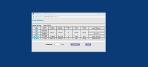

LAN1, LAN2, LAN4 link down on AC1750 Firmware Version V3.01.14
Hi, my ethernet LAN1, LAN2, and LAN4 all have a status of Link Down. Lan3 is working. My router is the AC1750 WiFi cable modem model C6300. The firmware version V3.01.14. Is there a way to fix thi...
