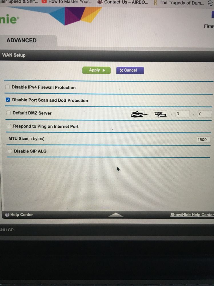

      Thanks.  I am not able to find any actual setting for NAT or NAT filter.  Is there another name for this?  I can't seem to find that in the advanced settings.  Do I need to shut off Port Forwarding?  My uPnP is enabled.
      • jtuckerj's avatar
        jtuckerj
        Thanks for all the help thus far.  Unfortunately,  I cannot locate where my NAT settings are under my WAN advanced settings.  Below is the picture shows what I see in my WAN advanced settings.  Any other thoughts?  Thanks so much!WAN advanced settings
