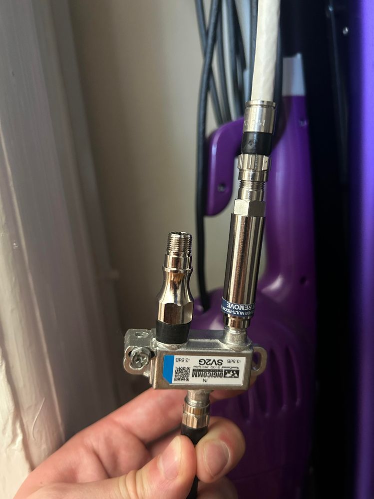

- cjc15Tutor
Just closing the loop here, a tech came and said while I was missing a filter, the signal looked fine on their end. They installed a splitter (-3.5db) and a filter. He does not think this was the major cause, and blamed it on the firmware / hardware of the router. Nonetheless, they still covered the cost so no complaints on my end. I have not had internet issues since they came out (Friday August 29) and my signal table seems much more stable based on the links you sent above (all powers below 7dB, 0 uncorrectables and way less correctables).
Thanks for all your help CrimpOn FURRYe38 , this is hopefully resolved!New signal info:

- cjc15Tutor
The following was installed.
