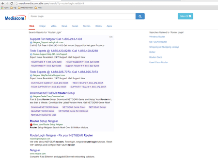

I get the message: You are not connected to your Routers WIFI network. To access routerlogin.net your device must be connected to your Router's WIFI network. Check your current connection and try again.
I used the 192.168.100.1 and finally got the laptop to pick up the WIFI after it said limited access or no internet. However now all the other wifi devices show no internet connection and before they would connect only one at a time. The 192.168.100.1 is missing several tabs it appears, the advanced tab only as Administration and has router mode set on NO, but when I change it to YES and apply the modem reboots and comes back to the NO mode. I downloaded the Netgear Genie for desktop and when I try to access the router I get a red error message: Netgear router is not found or not supported, Also make sure the router is not connected to the guest network of the router and no IPV6 is enabled. I am not tech savvy and can not figure out how to get this Router to open up and do what I needs to do.
