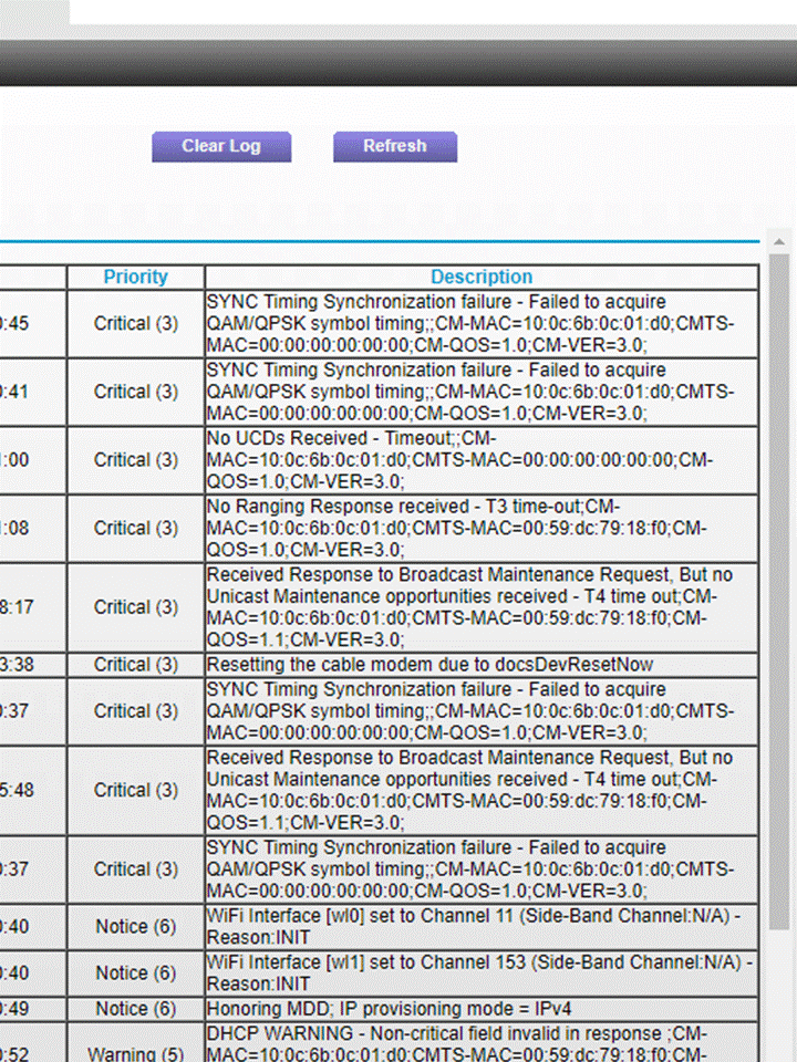

Netgear C7000v1 &v2 Drops wifi randomly?
So my wifi signal just drops and all my devices go offline. the leds are all lit and the routers SSID still shows up and when you try to connect to it it just says incorrect password. Once i unplug it and plug it back in wifi works for a random limited time and drops off again. This started with the C7000v1 that ive had for 2.5 years and I just bought C7000v2 thinking it was a hardware issue but still the same issue persists. I called xfinity and they say theres no outage in the area and I got a guy coming out to look at the line. Ive researched several topics with no "solved" issue. I dont understand and im running out of ideas and patience as my area is horrible cell signal and you cant do anything. Also Xfinity is the only people in the area otherwise I wouldve left. Did we ever figure out what the issue was? and Firmware v is up to date V1.02.13
Note: my Apple time capsule in the past has a green light but when it loses wifi it blinks and amber color. When signal drops its still green which only thing i read is because its hardwired into the router. so i plugged the ps4 hardwired into the router and it wont connect no matter what. I thought maybe it was a signal problem but anything hardwired would work.
