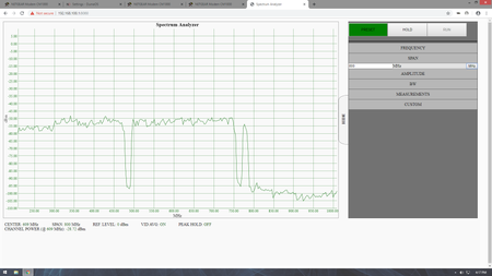

Mrberry12
May 19, 2019Aspirant
This is the fluctuation in the downstream power signal I am talking about... so if I have a -10db forward path attenuator to reduce a hot signal what causing downstream power to further increase? Temp of the area has been high 60s and at night mid 40s will 20 degrees cause that much of a fluctuation?
