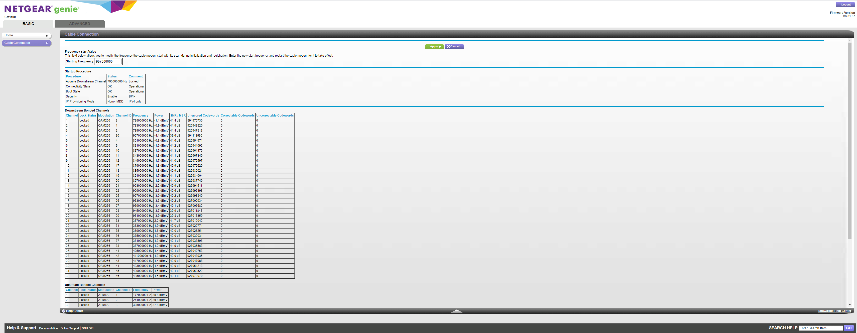

Attached is my power settings from my modem.
Last week, I had a splitter on my internet connection before it went crazy...
this week, I removed the splitter, and with the new one it still freaked out.
Any and all info is appreciated.
Thanks

- plemansJun 19, 2020Guru - Experienced User
Your upstream is to low. It can cause frequent drops.
have you had your isp check your line?

*Recommended Upstream signal levels are +35 dBmV to +49 dBmV (DOCSIS 3.1)
And those are just snap shots. The dbmv changes throughout the day.
