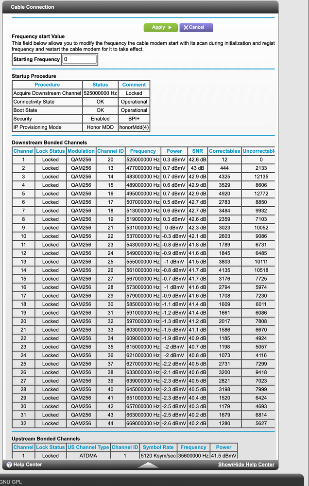

Thank you for the suggestions. The thing is that everything was working just fine until Xfinity did an upgrade in our area on February 15. Then all the issues started. All the connections and cables are the same as before. Still, they are pointing to the modem as the problem. Attached is the log. Hopefully this provides some help. Thanks again.

I see lots of correctables and un-correctables that should be mostly zeros across all channels.

You have a lot of errors in the line.
Check your line/connections.
Start with removing any amplifiers, signal attenuators, or splitters from the coax.
From there check the line for kinks, damage, moisture in the line.
Check the connectors for improperly made ends, foil touching the copper coax line, loose connections, bad/old/cheap connectors, or corroded connections. Replace them if you do.
If you can, simply connect the modem right where the coax comes into the home. This prevents wiring in the home from being the issue. And some ISP’s charge if the wiring issue is in the home. So this helps prevent this.If that doesn't help, the isp needs to check the line

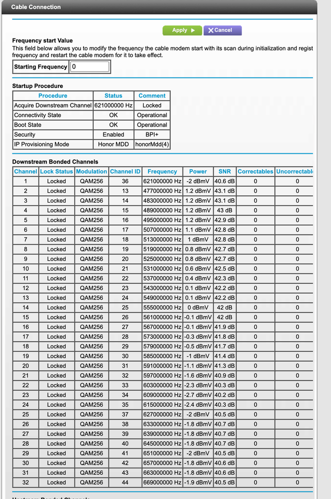

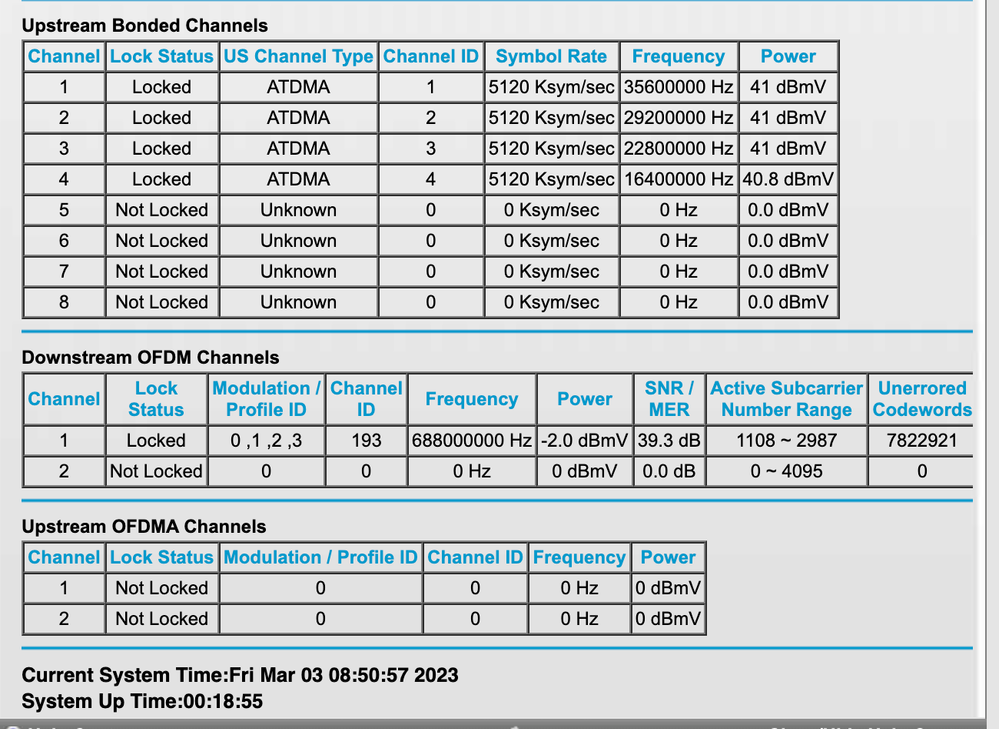

- anteroalAspirant
I removed a connector and short cable that was between the modem and the cable coming into the house. Here's the new log
