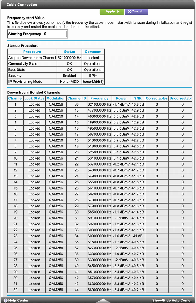

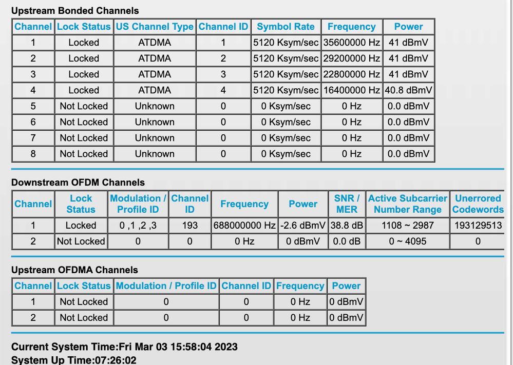

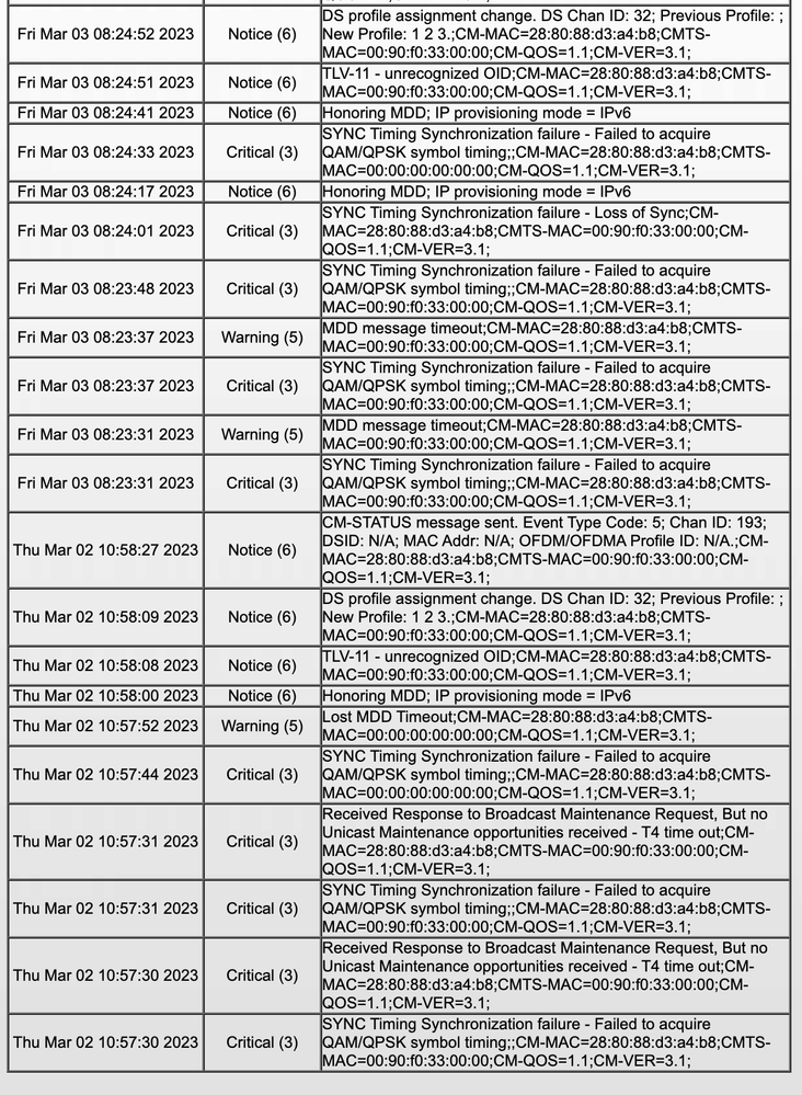

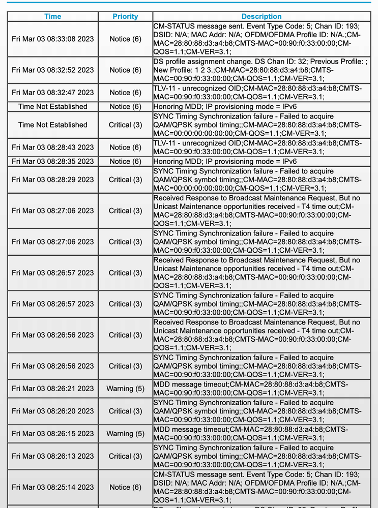

Terrible instability all day today. I'm having to use a hotspot on my phone to send this. Here's all the logs.
- FURRYe38Mar 04, 2023Guru - Experienced User
All those Criticals and Warnings in the event logs indicate a signal line issue. The ISP needs to review those and resolve them. Have the ISP review these same logs.
