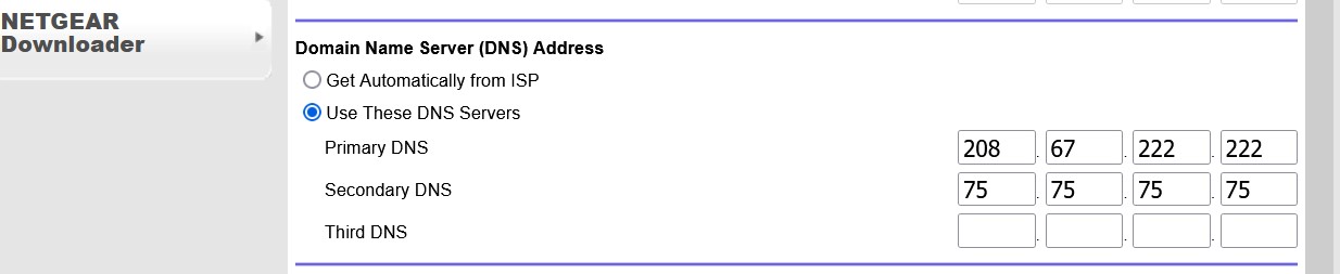

Attached is a screen snip from my Basic -> Internet page. It may be different for a C7800. If you check the box get automatically from the ISP it will show what your ISP provides.
The IPv4 settings you are using are from Google. If you search on the internet you will find public settings from Cloudflare, OpenDNS, Next DNS and others. Different locations will have a different response depending on what you are trying to do. I chose OpenDNS because of my location in Washington state. On occasion the DNS from my ISP would just clog up any requests from my router.
