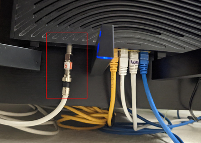

So with the downstream power levels, I remember when the ISP technician came over to setup the internet, he mentioned that the location of the model is close to the junction box so he added an attachment to the end of my modem where the coaxial cable connects. He mentioned the attachment will filter/reduce the power level so things run correctly. Would that be the cause of the high power levels, should I try a longer coax cable to simulate extra distance from the junction box? I attached an image of what the filter attachment looks like.

ElderAgent wrote:So with the downstream power levels, I remember when the ISP technician came over to setup the internet, he mentioned that the location of the model is close to the junction box so he added an attachment to the end of my modem where the coaxial cable connects. He mentioned the attachment will filter/reduce the power level so things run correctly. Would that be the cause of the high power levels, should I try a longer coax cable to simulate extra distance from the junction box? I attached an image of what the filter attachment looks like.
The power levels are still too high. They need to be reduced further to be within specification. Does this filter have a brand name or part number on it? You may need to have the ISP technician back to install a different filter.
