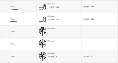

I have left the router alone after the last reboot. If I interface with it via the Web Browser GUI I run the risk of having the GUI hang with the hour glass and then a subsequent router freeze. Sometimes only the Wired devices are able to connect. I have made no attempts to change any setting, but I'm sure the devices names, icons and IP addresses reservations are gone. Some of the devices that I ping on predetermine IP addresses are currently using a randomly assigned IP addresses.
