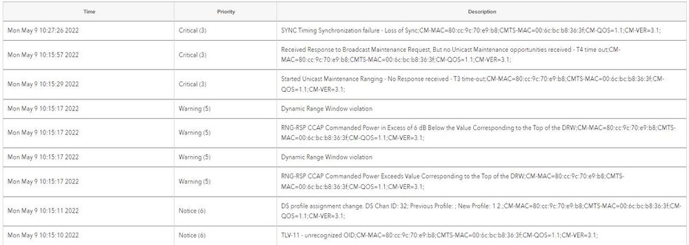

Thank you for the information. The lines within my house were all just replaced last week at the start of these issues, as the first day or so I hadn't noticed any real issues with the modem/router yet, but I wasn't home much. I called Spectrum (ISP) and they came out and determined that my lines had some issues so they replaced all my internal lines. This week (yesterday) they replaced all the external lines running to the house.
I have no amplifiers, splitters, etc. It is just the single line running from the box outside directly to my modem/router and no other connections. That line tests out fine as far as the ISP is telling me.
I have attached my full log report, as far as what is available to me which seems to only be the last two days. Please let me know if there is any other information I can provide to better help, as I am a novice at decoding these issues. I have run ping loops and thats about as far as my abilities take me on my own.
Thank you again,
Mike Bauer
- Sk8shorty-01May 10, 2022Guide
The line internal to my home were all run recently as well by Spectrum (my ISP) and I have had three different techs come test them and tell me that they are in full working order. Obviously, I cannot absolutely confirm that as true as I don't have access to their handheld equipment but all gave me similar information and read-outs.
We have no amplifiers or splitters in the house, the modem/router is connected directly to the line that runs from the outside box directly to my office.
Here are the log screenshots, and again I appreciate all the efforts!
Thanks,
Mike Bauer

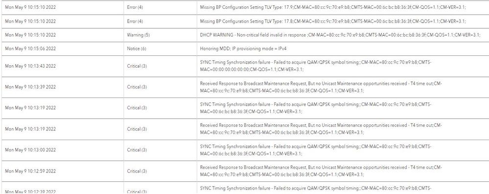

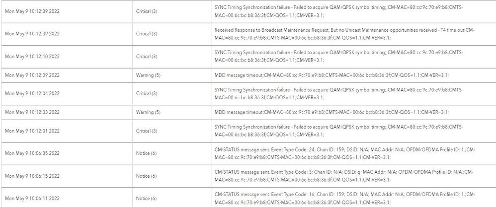

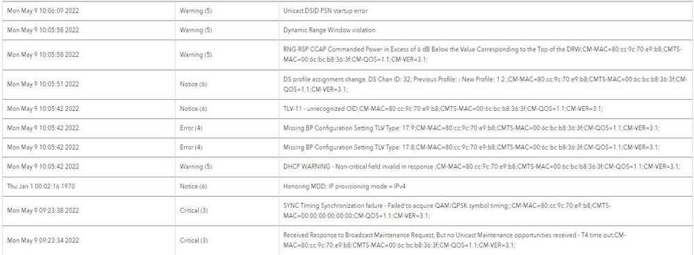

- plemansMay 10, 2022Guru - Experienced User
thats the logs. a bit down from that should be the "event logs".
That shows the modem side.
My apologies, here you are.
