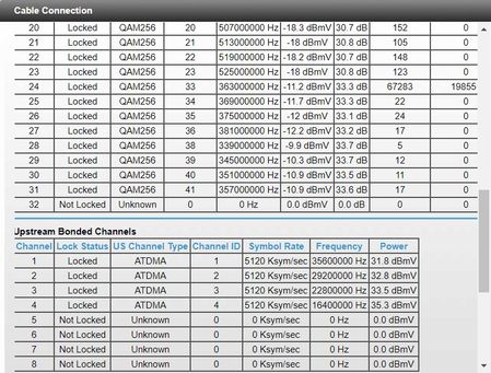

Night Hawk CM1200 Downstream Blinking
Off and on my downstream led starts blinking and I loose my internet. I have seen some previous posts but I though I would post my connection. Looks like 24 is an issue. Any guidance is appreciate...

Power is too LOW and you have a ton of correctables and un-correctables that should be zeros.

After the outage yesterday, today I started losing my downstream at times again. My work computer uses a VPN. When I finally got hold of a Comcast agent and going through all the reboots they blamed it on my VPN. So I said I will disable the VPN this weekend and if it fails then send an tech out. Here are my current logs. what do you think.

Power levels are out of spec and way TOO LOW:
https://kb.netgear.com/24311/Power-level-guidelines-for-a-NETGEAR-cable-modem-router
ISP needs to raise the power here.
I see lots of correctables and UN-Correctables that should be zeros accross all channels.
Lots of criticals as well. Any Criticals, Errors or Warnings seen in the event logs needs to be reviewed and resolved by the ISP. Indicates a signal issue on the ISP line up to the modem.
