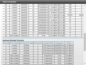

Off and on my downstream led starts blinking and I loose my internet. I have seen some previous posts but I though I would post my connection. Looks like 24 is an issue. Any guidance is appreciate...

Have the ISP take a look at the information I pointed too.

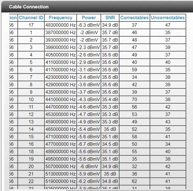

I just had Comcast fix an issue where my power levels were -18 instead of -7 or greater. However, I am still seeing uncorrectable errors in the thousands. Is this normal or could the modem be going bad? The pic below is right after I rebooted the modem. Thanks for any insight.
