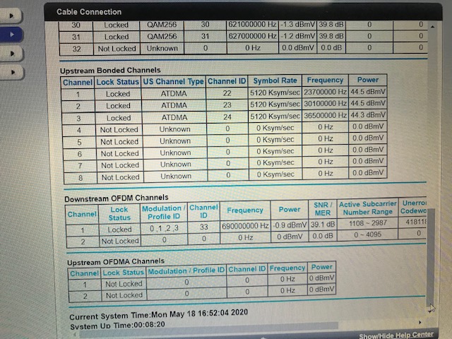

Thank you for your reply! To answer your questions:
1) Please see photo.
2) I was connected directly to the new modem. My ASUS router was unplugged?disconnected from the modem. I was connected to port 1.
3) I tested on a few speed test sites, and one of them was the speedtest.xfinity site. The xfinity speed test site yeilded me 252.6 Mbps.
4) I was testing from my laptop. Its an Acer Aspire 6290 series.
5) Only port 1 was being used as mentioned above.
Since the install of the new modem and the hours on the phone with xfinity tech support and "advanced tech support", they scheduled a field tech to come out. I told him what the issues were and he started at the junction box located at the back of the house. This box is where the main run from the street is connected to the cable that runs to the powered amplifier. He found the cable going from the juction box to the powered amplifier damaged. He stated that it looked like a previous tech closed the door on the junction box onto the cable and comprimised it. He also disconnected the main cable run from the street and tested it. He said that the cable was faulting for issues with channel bonding. He said they will need the to replace the cable and ran a temporary RJ6 above the ground from the street box to the junction box on the house. After he did all of that, I performed another speed test and the results were similar. The tech stated that I should be seeing at least in the 900's Mbps. We currently have an RJ11 buried and they will be replacing that with the same. But it still leaves me with just over 252 Mbps speeds when I'm paying for 1Gb.

You can post more pictures but you need to do it on seperate posts. there should be more info to check :)
1. The aspire 6290 was a pretty solid laptop. when it came out 12 years ago. Not saying that is the issue but try several devices. And with a device known to hit gigabit speeds. Having a gigabit port doesn't mean devices will hit full gig speeds. especially with older devices.
2. Try having them re-provision the modem. I've had them send the wrong provisioning file before.
2. Did the tech actually hook up a modem and test it? If they're saying it gets full speeds, have them hook up and prove it. Many times they say "we show full gigabit on our end" but how are they actually seeing that? there's isn't away.
- AudiUrQMay 24, 2020Aspirant
Yes...sigh....this is an old laptop. I get all the secondhand stuff after the kids! The modem info came from the last xfinity tech I was on the phone with. And yes, they stated that they saw full gigabit speeds. Due to this pandemic situation, the tech who came to the house could not come into the house. Xfinity or whatever the company policy was prevented that. I was not in a position, nor was the weather cooperating to have he modem outside at the junction box.
