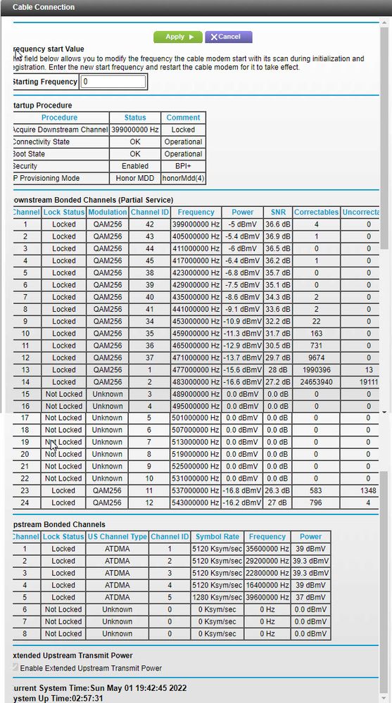

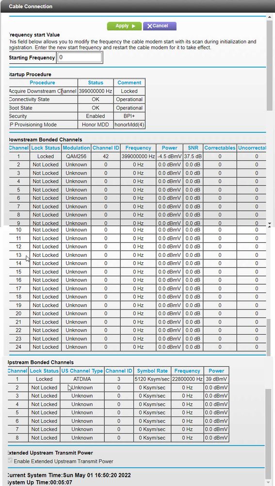

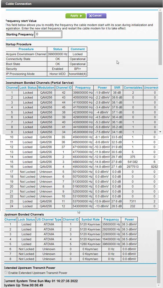

Nighthawk AC1900 C7000v2 Downstream Channel Indicator Light Blinking with slow speeds
I am having issues with my Netgear Nighthawk AC1900 WIFI Cable Modem Router, Model C7000V2. It is about 5 months old. It was working fine for the last four months. Over a month ago, the indicator lig...
  • plemans's avatar
    plemans
    May 02, 2022
    If you've checked all the cables/connectors to ensure you're good, then the ISP needs to check the line as you have power issues (out of spec) and a bunch of errors
