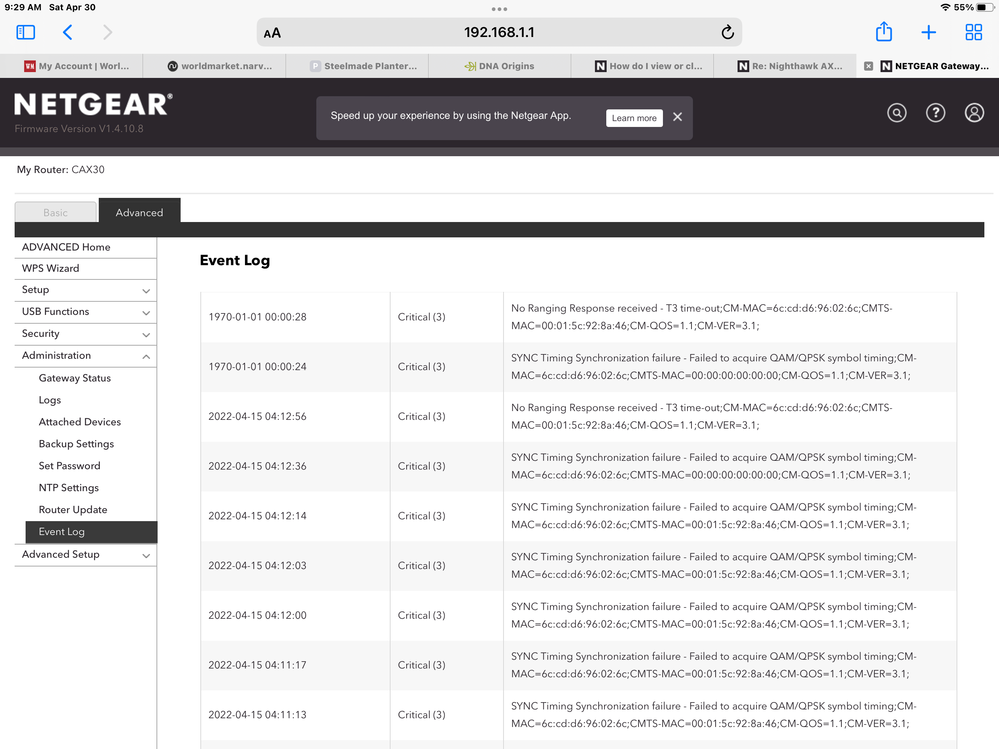

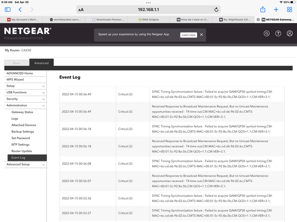

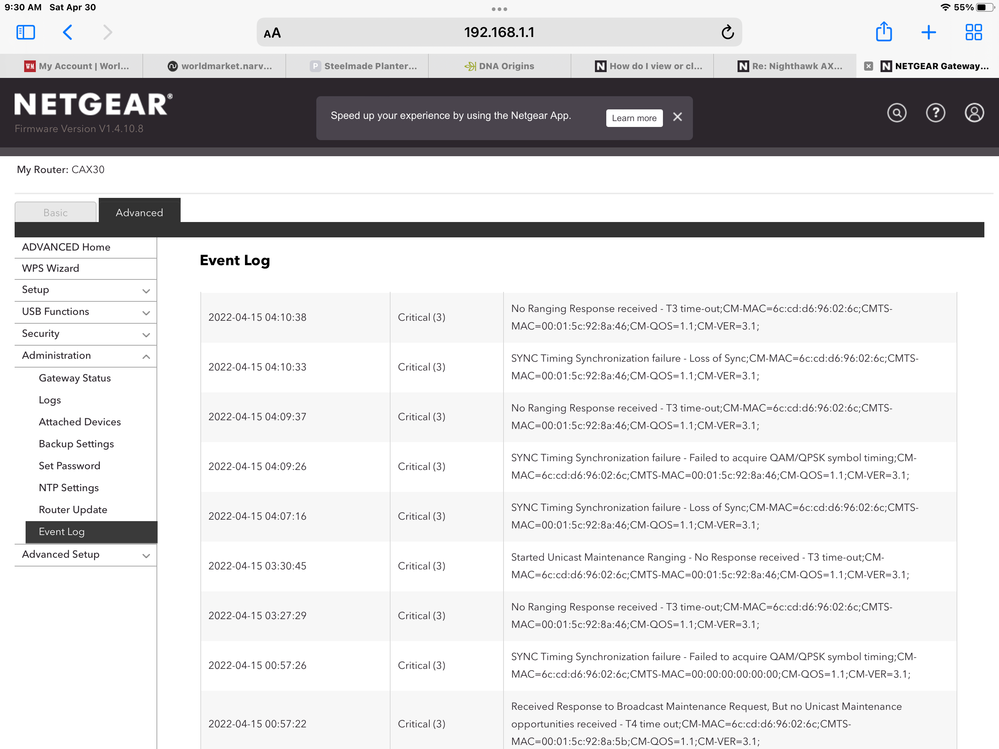

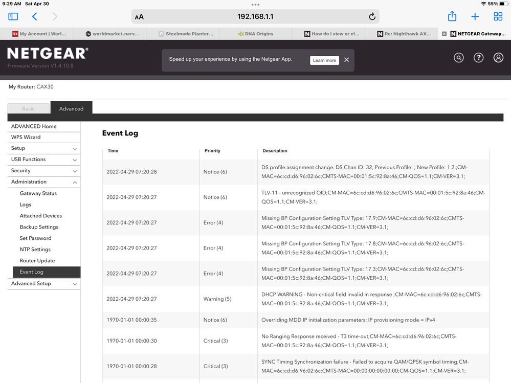

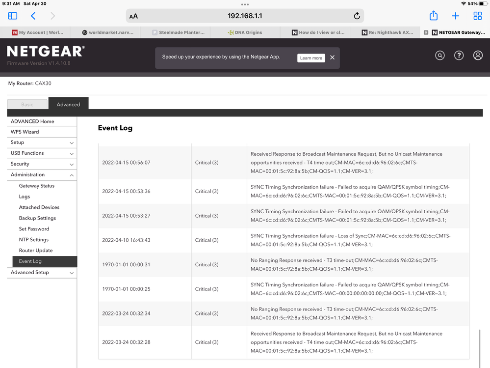

- DrWarpathApr 30, 2022Guide
Super helpful! Thanks. Here are the event logs and to the untrained eye, there appear to be issues. What do you make of it?
- plemansApr 30, 2022Guru - Experienced User
Your logs are indicating issues. do you also have the cable connections page? (shows upstream/downstream info).
If you're on the home page, click on the internet icon
