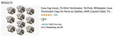

A coax terminator for the open input might do the job. The snip is from Amazon.
