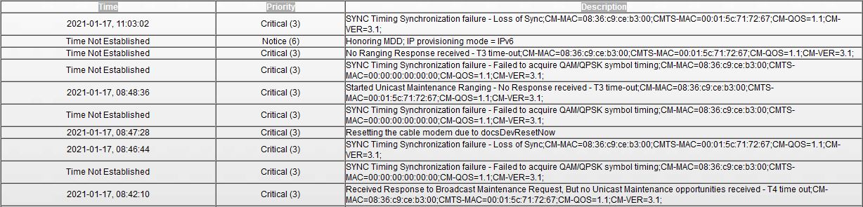

Jan 17, 2021Aspirant
The inserts photo option didn't work so here is the event logs.

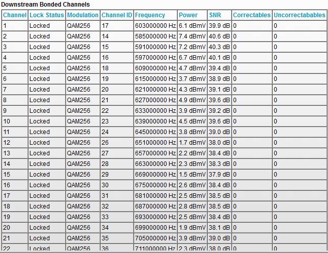

Got a few more files. Those numbers seem to be all over the place and not what it should be per someone eles post with the same modem.
- Monte70carJan 17, 2021Aspirant
Upstream power.
- plemansJan 17, 2021Guru - Experienced User
And no amplifiers in line? Or anything else?
your upstream power is low and its going to cause issues.
And you're log is indicating line/power issues.
- Monte70carJan 17, 2021AspirantNo amplifiers, no splitters. Straight connection from the outside of the home into the room with the modem/router is at. I asked the ISP tech about turning up the power as I saw where they run it lower and was told they can’t turn up the upstream power. At that point I told the tech he made go because I had already did the research and knew the issues was the power. The reaction I got was it worked the day before what was the power then which was a good question as I had no need to look at it as the network was up. Which could also be why it works and then cuts out like it’s doing right now. At the end I believe we are switching ISP companies and then have to figure out a new way to cover a three floor townhouse with 2550sqft.
- plemansJan 18, 2021Guru - Experienced User
What I've had to do with comcast before is to rent a modem from them for a month/2 to prove that it wasn't a modem issue.
many times they're set that the line is fine.
but they truly can't just "turn up the upstream power". thats the modem negotiating with the cmts for what power level it needs to use to communicate with it. It could be an issue with the cmts.
