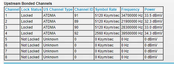

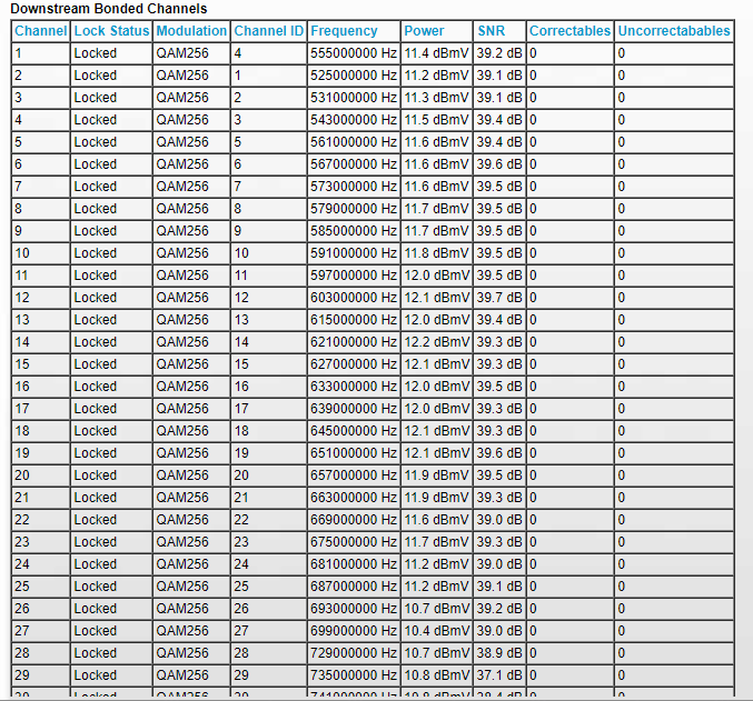

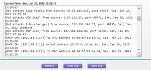

Nighthawk C7800 drops connection, has DOS Attacks, and 8/32 locked channels.
Attaached are my logs. Additional information includes that I indeed have a cable splitter in my box, but it connects it to only to the direct cable. Sooooo there is no need for the splitter. Does th...

remove any splitters, amplifiers, or signal attenuators from you coax line.
Check the link for kinks, damage, loose/old/bad/cheap connectors and replace them if you do.
Move the modem to right where the coax comes into the home and direct connect it.
If after doing that the logs/connections still look the same, the ISP needs to check the line.

- plemansJan 30, 2022Guru - Experienced User
The reason to remove the splitter is because they can go bad and cause interference on your line.
You're currently not locking the channels you should and you logs indicate a line issue connecting back to the ISP.
So I'd take out anything in the line that could be causing issues.
- basstyler155Jan 30, 2022Star
Plemans, I've removed the splitter, and it has effected the power levels in the following way:
This is post splitter removal:
Power levels are a bit high but they're at least locking all the channels.
I'd be betting on a sketchy splitter.
