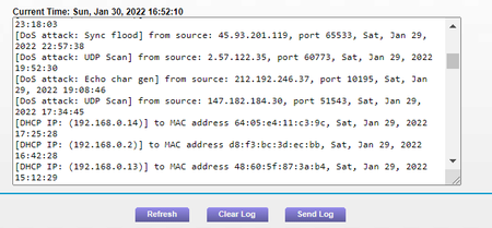

Nighthawk C7800 drops connection, has DOS Attacks, and 8/32 locked channels.
Attaached are my logs. Additional information includes that I indeed have a cable splitter in my box, but it connects it to only to the direct cable. Sooooo there is no need for the splitter. Does th...

- basstyler155Jan 30, 2022Star
Plemans, I've removed the splitter, and it has effected the power levels in the following way:
This is post splitter removal:
- plemansJan 30, 2022Guru - Experienced User
Power levels are a bit high but they're at least locking all the channels.
I'd be betting on a sketchy splitter.
Is it running better?
I mean it is running fine. I'm paying for 200 mbps and according to speedtest I am currently getting 80mbps on 2.4ghz and 220mbps on the 5ghz band. I usually experience my disconnections in the morning. I wake up to no internet and keep resetting it until 9AM where it finally settles down and works consistently.
Should I reattach the splitter since my power levels are off now? Contact ISP? They'll probably know I tampered with it. I'll check the logs in the morning as well.
