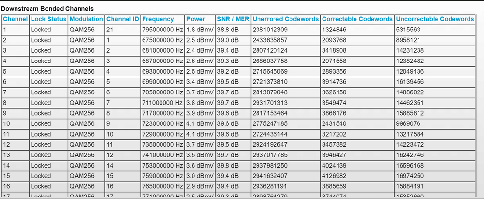

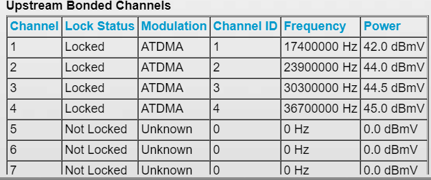

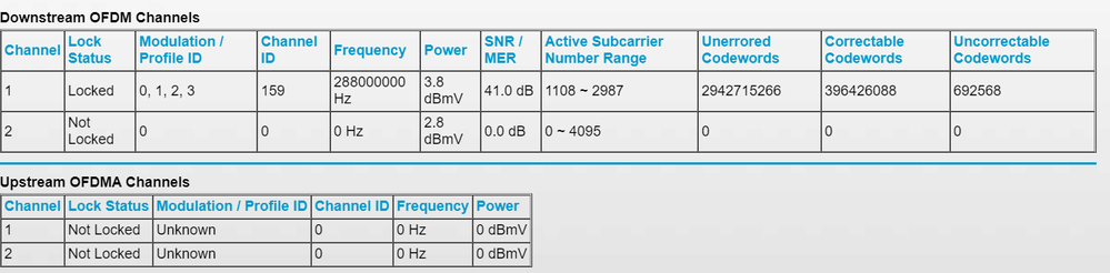

- FURRYe38Oct 08, 2021Guru - Experienced User
Seeing lots of correctablesn and uncorrectables. Something that should not be happening like this. The ISP needs to check the line up to the modem. Also have them check the lots from the modem as well so they can see whats happening at the modem.

- asg1252Oct 08, 2021Aspirant
Okay I will contact them and ask for a technician to come out again, if they come out, can I show them this report and they should know what it means and what to check? I have Cox as my ISP

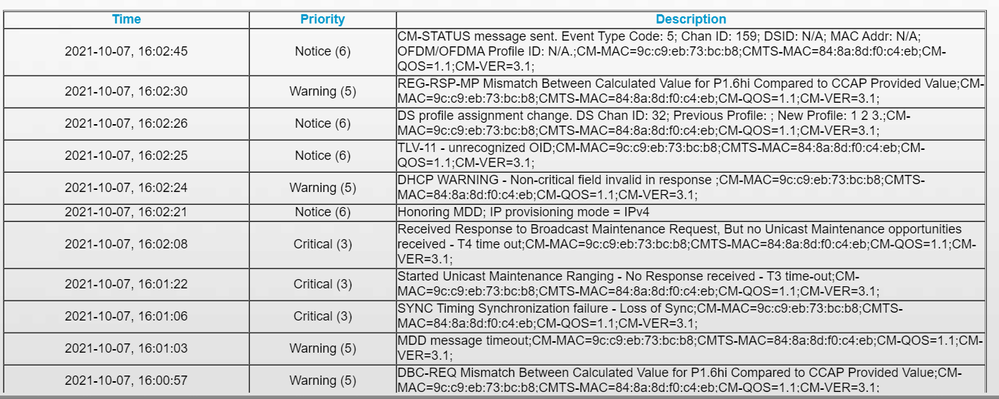

Yes who them that page for sure and the Events log page too.
Have the ISP check the signal and line quality UP to the modem. Be sure the ISP provisions the modem correctly.
Be sure there are no coax cable line splitters in the between the modem and ISP service box.
Be sure your using good quality RG6 coax cable up to the modem.
