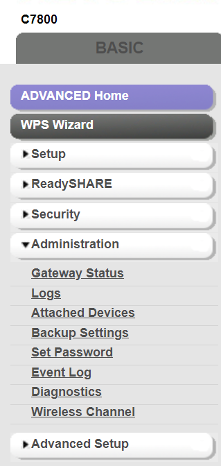

Nighthawk C7800 X4S cable modem router combo
How do you turn off the router portion of this combo? This router does not provide parental controls, which we need. In order to gain parental controls we were advised by netgear IT, to purchase a c...

We tried this and do not have "router mode" under advanced then administration.

click the administration tab on the left and not the advanced setup tab you hit.
- reneegdouglasFeb 15, 2022Tutor
Thought I replied to this but I don't see my response. We tried this before posting for help and do not have the router option there either.
- plemansFeb 15, 2022Guru - Experienced User
Not sure why the option isn't there. I know its in that location on my C7000 and CAX80.
You can try just disabling its wifi and putting the new routers IP address into the C7800's dmz.
