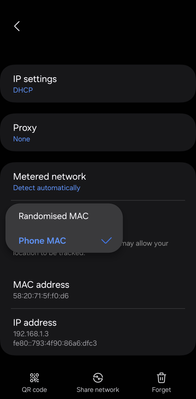

Checked out the link you provided. On my S21 Ultra the only thing that comes close is in the enabled developer options called "Wi-fi non=persistent MAC randomization" which is off. One UI 6.1, Android 14. Nothing under the regular settings that would achieve this. Good info to have, though.
- Connections
- Wi-Fi
- [Current connection]
- Settings
- View more
- MAC address type
Randomised Mac
- luddite309Jul 29, 2024Aspirant
Ok, I do find it now. Funny how a search within settings of "randomized mac address" didn't find anything but the aforementioned setting in developer options. So far one of the settings changes I made still seems to be working, but I'll keep an eye on it all and change that setting if need be.
Thanks.
- michaelkenwardJul 29, 2024Guru - Experienced User
It is well hidden,and almost certainly a red herring, just a boilerplate response rather than a reasoned analysis of what is going on at our end. I posted it simply to let you know where it is. I have never come across an Android user who has suffered from that setting.
