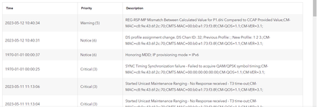

Nighthawk cax30 dropping internet connectivity almost daily
The first couple months after purchasing the Nighthawk CZX30 router it was working great, but the last couple months it's started having major connectivity issues, sometimes as frequently as several ...
May 12, 2023Guru - Experienced User
Please post a copy and paste of the modems connection status full page page.
https://kb.netgear.com/30007/How-do-I-obtain-the-cable-connection-information-from-a-NETGEAR-cable-modem-modem-router
Any Critical, Errors or Warnings need in the event log indicates a signal line issue from the ISP service box and needs to be reviewed by the ISP and resolved.

This is the status right now (when it's working)...

You have a ton of correctables and some un-correctables. Means the modem is going lots of processing to make things work coming in from the ISP side and these should be mostly all zeros.
Power levels or good however seem a bit all over the place.
Have the ISP check the signal and line quality UP to the modem. Be sure the ISP provisions the modem correctly.
Be sure there are no coax cable line splitters in the between the modem and ISP service box.
Be sure your using good quality RG6 coax cable up to the modem.
Start with removing any amplifiers, signal attenuators, or splitters from the coax.
From there check the line for kinks, damage, moisture in the line.
Check the connectors for improperly made ends, foil touching the copper coax line, loose connections, bad/old/cheap connectors, or corroded connections. Replace them if you do.
Be sure to power OFF the modem for 1 minute then back ON.
https://community.netgear.com/t5/Cable-Modems-Routers/General-info-and-Troubleshooting-for-Cable-Modems/m-p/1530376#M12853
https://kb.netgear.com/24311/Power-level-guidelines-for-a-NETGEAR-cable-modem-router
https://www.duckware.com/tech/solving-intermittent-cable-modem-issues.html
https://highspeed.tips/docsis-events/Have the ISP check the event logs for those criticals, errors and warnings. They need to resolve them.
