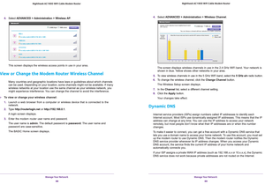

Nighthawk CAX30 has no internet on 2.4Ghz
Problem solved after hours of troubleshooting. Short answer, the auto channel function was selecting same radio channel that several others in same apartment complex were also using. Went to manual a...
