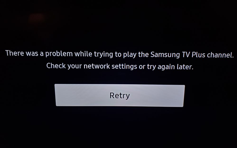

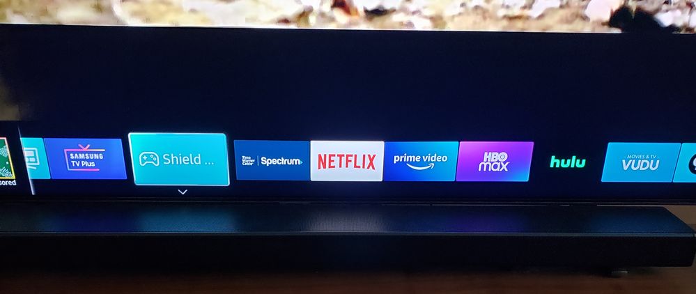

I have a 2019 Samsung Q80R QLED TV and have not watched Samsung TV in a while. I'm sure that it worked fine with my previous setup (Motorola SB6183 Modem and Netgear WNDR4500 Router) - After comming accross this thread I decided to test the Samsung TV Plus and noticed that it no longer works. I get the error message pictured. Netflix, Amazon Prime, HBO Max, Hulu, Vudu, YouTube and all the other streaming apps on the TV work without any issues. The problem appears to be only with Samsung TV Plus. I called my sister who has the same TV and to whom I gifted my old Modem and Router and Samsung TV Plus works fine. We both have the same Spectrum service. My CAX80 has Modem firmware 1.02.08 and Router firmware 2.1.1.4 - Something is not right here.
