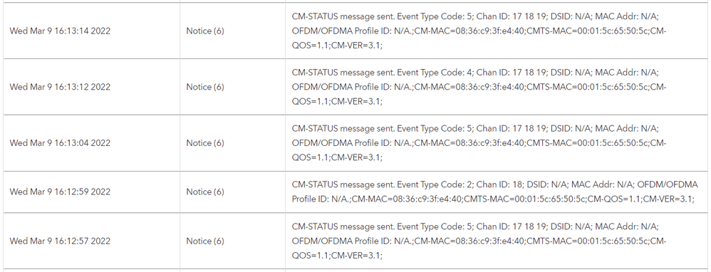

Event logs:

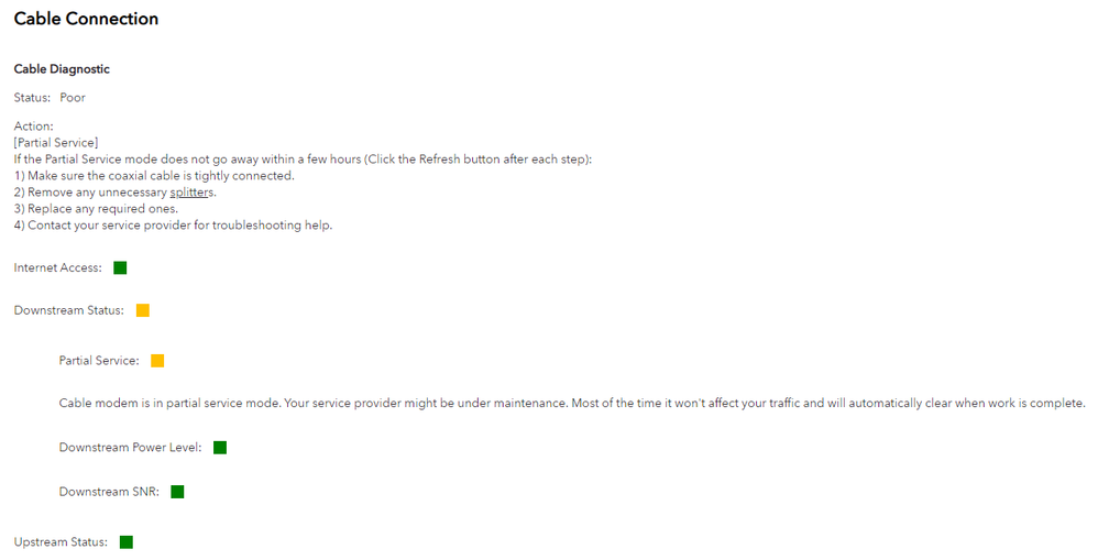

    Cable Diagnostic
    Status: Poor
    Action:
    [Partial Service]
    If the Partial Service mode does not go away within a few hours (Click the Refresh button after each step):
    1) Make sure the coaxial cable is tightly connected.
    2) Remove any unnecessary splitters.
    3) Replace any required ones.
    4) Contact your service provider for troubleshooting help.
    [Downstream SNR]
    Try these actions (Click the Refresh button after each step):
    3) Replace any required splitters.
    Internet Access: Good
    Downstream Status: Poor
    Partial Service: Poor
    Cable modem is in partial service mode. Your service provider might be under maintenance. Most of the time it won't affect your traffic and will automatically clear when work is complete.
    Downstream Power Level: Good
    Downstream SNR: Poor
    Downstream SNR (signal to noise ratio) is poor (29.0dB). The recommended level is greater than 30dB.
    Upstream Status: Good
    Upstream Power Level: Good
    Current time: Wed Mar 09 16:33:44 2022

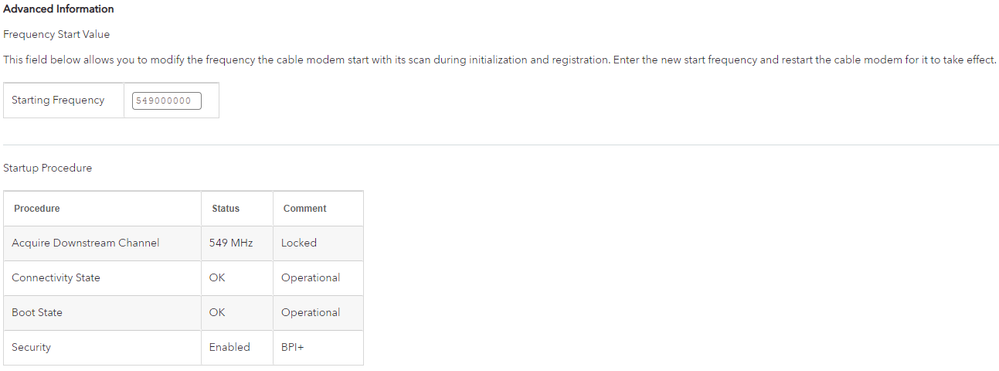

    Startup Procedure
    Acquire Downstream Channel: 549 MHz Locked
    Connectivity State: OK Operational
    Boot State: OK Operational
    Security: Enabled BPI+

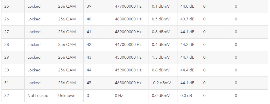

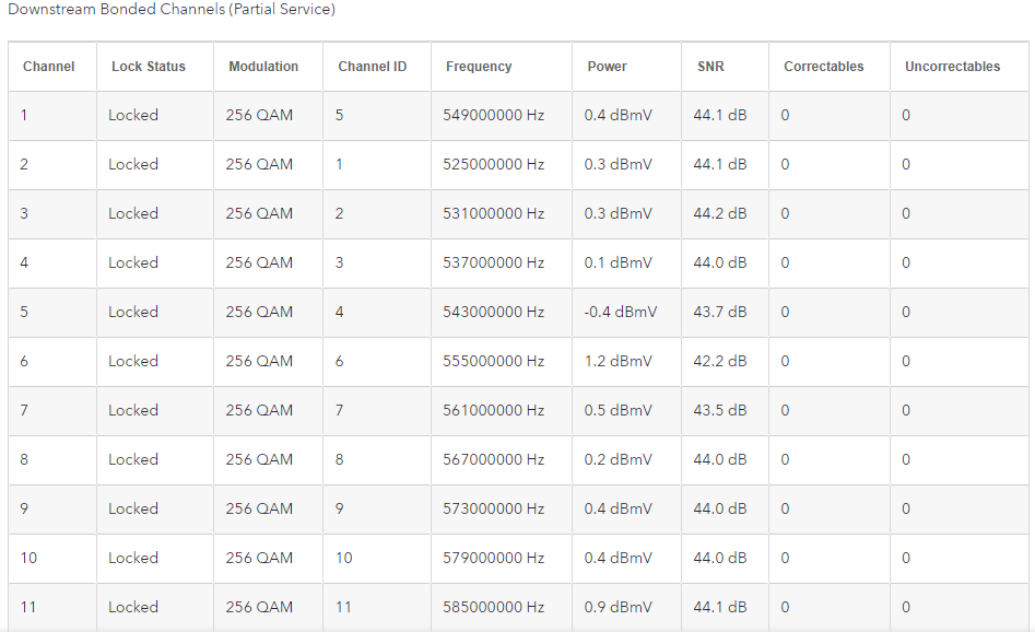

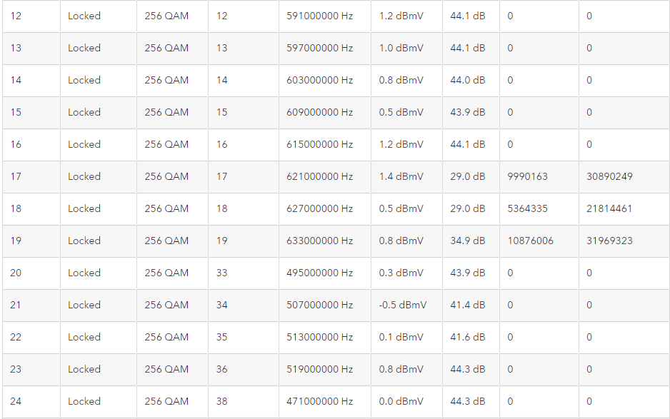

    Downstream Bonded Channels
    Channel LockedStatus Modulation ChannelID Frequency Power SNR Correctables Uncorrectables
    1 Locked 256 QAM 5 549000000 Hz 0.4 dBmV 44.1 dB 0 0
    2 Locked 256 QAM 1 525000000 Hz 0.3 dBmV 44.1 dB 0 0
    3 Locked 256 QAM 2 531000000 Hz 0.3 dBmV 44.2 dB 0 0
    4 Locked 256 QAM 3 537000000 Hz 0.1 dBmV 44 dB 0 0
    5 Locked 256 QAM 4 543000000 Hz -0.4 dBmV 43.7 dB 0 0
    6 Locked 256 QAM 6 555000000 Hz 1.2 dBmV 42.2 dB 0 0
    7 Locked 256 QAM 7 561000000 Hz 0.5 dBmV 43.5 dB 0 0
    8 Locked 256 QAM 8 567000000 Hz 0.2 dBmV 44 dB 0 0
    9 Locked 256 QAM 9 573000000 Hz 0.4 dBmV 44 dB 0 0
    10 Locked 256 QAM 10 579000000 Hz 0.4 dBmV 44 dB 0 0
    11 Locked 256 QAM 11 585000000 Hz 0.9 dBmV 44.1 dB 0 0
    12 Locked 256 QAM 12 591000000 Hz 1.2 dBmV 44.1 dB 0 0
    13 Locked 256 QAM 13 597000000 Hz 1 dBmV 44.1 dB 0 0
    14 Locked 256 QAM 14 603000000 Hz 0.8 dBmV 44 dB 0 0
    15 Locked 256 QAM 15 609000000 Hz 0.5 dBmV 43.9 dB 0 0
    16 Locked 256 QAM 16 615000000 Hz 1.2 dBmV 44.1 dB 0 0
    17 Locked 256 QAM 17 621000000 Hz 1.4 dBmV 29 dB 9990163 30890249
    18 Locked 256 QAM 18 627000000 Hz 0.5 dBmV 29 dB 5364335 21814461
    19 Locked 256 QAM 19 633000000 Hz 0.8 dBmV 34.9 dB 10876006 31969323
    20 Locked 256 QAM 33 495000000 Hz 0.3 dBmV 43.9 dB 0 0
    21 Locked 256 QAM 34 507000000 Hz -0.5 dBmV 41.4 dB 0 0
    22 Locked 256 QAM 35 513000000 Hz 0.1 dBmV 41.6 dB 0 0
    23 Locked 256 QAM 36 519000000 Hz 0.8 dBmV 44.3 dB 0 0
    24 Locked 256 QAM 38 471000000 Hz 0 dBmV 44.3 dB 0 0
    25 Locked 256 QAM 39 477000000 Hz 0.1 dBmV 44 dB 0 0
    26 Locked 256 QAM 40 483000000 Hz 0.5 dBmV 43.7 dB 0 0
    27 Locked 256 QAM 41 489000000 Hz 0.8 dBmV 44.1 dB 0 0
    28 Locked 256 QAM 42 447000000 Hz 0.4 dBmV 44.2 dB 0 0
    29 Locked 256 QAM 43 453000000 Hz 1.3 dBmV 44.7 dB 0 0
    30 Locked 256 QAM 44 459000000 Hz 0.8 dBmV 44.4 dB 0 0
    31 Locked 256 QAM 45 465000000 Hz -0.2 dBmV 44.1 dB 0 0
    32 Not Locked Unknown 0 0 Hz 0.0 0.0 0 0

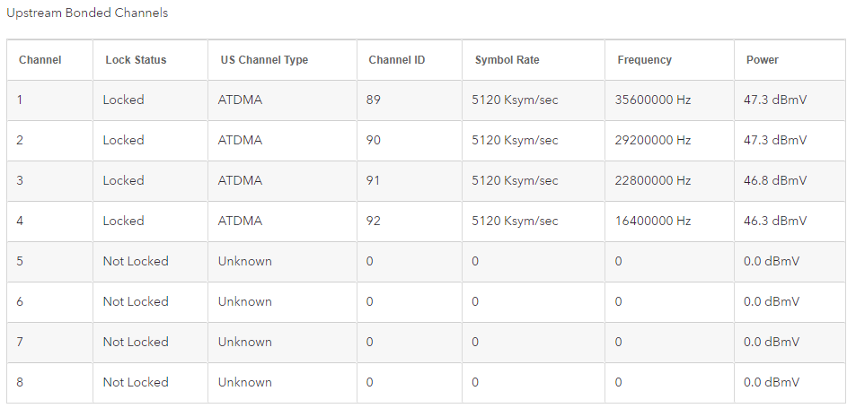

    Upstream Bonded Channels
    Channel LockedStatus ChannelType ChannelID SymbolRate Frequency Power
    1 Locked ATDMA 89 5120 Ksym/sec 35600000 Hz 47.3 dBmV
    2 Locked ATDMA 90 5120 Ksym/sec 29200000 Hz 47.3 dBmV
    3 Locked ATDMA 91 5120 Ksym/sec 22800000 Hz 46.8 dBmV
    4 Locked ATDMA 92 5120 Ksym/sec 16400000 Hz 46.3 dBmV
    5 Not Locked Unknown 0 0 0 0.0
    6 Not Locked Unknown 0 0 0 0.0
    7 Not Locked Unknown 0 0 0 0.0
    8 Not Locked Unknown 0 0 0 0.0

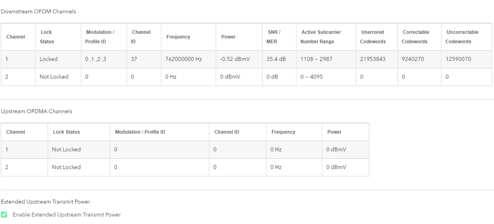

    Downstream OFDM Channels
    Channel LockedStatus ProfileID ChannelID Frequency Power SNR/MER ActiveSubcarrier Unerror Correctable Uncorrectable
    1 Locked 0 ,1 ,2 ,3 37 762000000 Hz -0.42 dBmV 35.7 dB 1108 ~ 2987 23276214 9929979 13221847
    2 Not Locked 0 0 0 Hz 0 dBmV 0 dB 0 ~ 4095 0 0 0

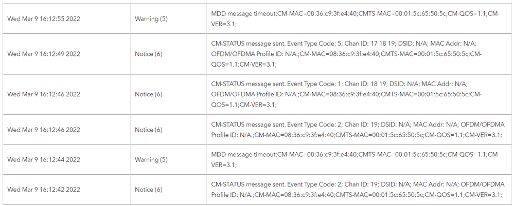

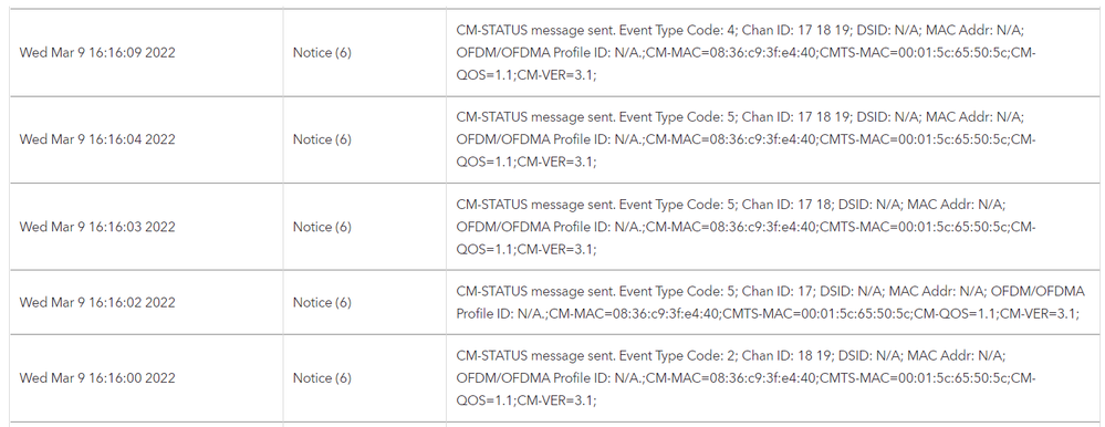

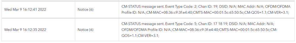

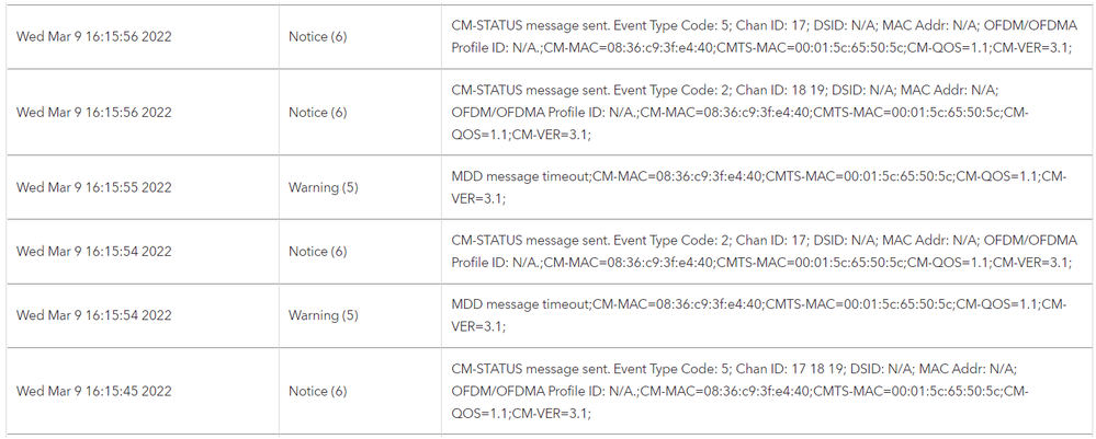

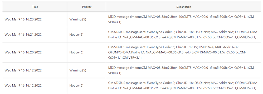

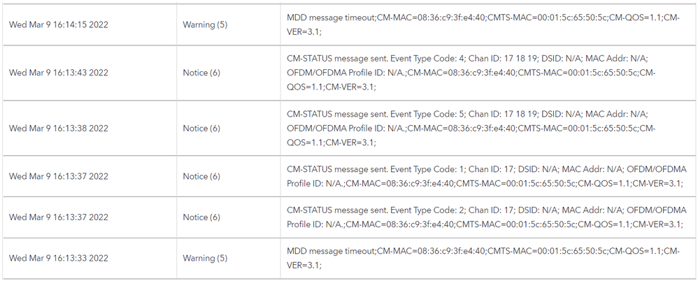

    Event Log
    Time Priority Description
    Wed Mar 9 16:33:58 2022 Notice CM-STATUS message sent. Event Type Code: 4; Chan ID: 18 19; DSID: N/A; MAC Addr: N/A; OFDM/OFDMA Profile ID: N/A.;CM-MAC=08:36:c9:3f:e4:40;CMTS-MAC=00:01:5c:65:50:5c;CM-QOS=1.1;CM-VER=3.1;
    Wed Mar 9 16:33:56 2022 Notice CM-STATUS message sent. Event Type Code: 2; Chan ID: 17; DSID: N/A; MAC Addr: N/A; OFDM/OFDMA Profile ID: N/A.;CM-MAC=08:36:c9:3f:e4:40;CMTS-MAC=00:01:5c:65:50:5c;CM-QOS=1.1;CM-VER=3.1;
    Wed Mar 9 16:33:55 2022 Notice CM-STATUS message sent. Event Type Code: 5; Chan ID: 18 19; DSID: N/A; MAC Addr: N/A; OFDM/OFDMA Profile ID: N/A.;CM-MAC=08:36:c9:3f:e4:40;CMTS-MAC=00:01:5c:65:50:5c;CM-QOS=1.1;CM-VER=3.1;
    Wed Mar 9 16:33:55 2022 Warning MDD message timeout;CM-MAC=08:36:c9:3f:e4:40;CMTS-MAC=00:01:5c:65:50:5c;CM-QOS=1.1;CM-VER=3.1;
    Wed Mar 9 16:33:51 2022 Notice CM-STATUS message sent. Event Type Code: 5; Chan ID: 17 18 19; DSID: N/A; MAC Addr: N/A; OFDM/OFDMA Profile ID: N/A.;CM-MAC=08:36:c9:3f:e4:40;CMTS-MAC=00:01:5c:65:50:5c;CM-QOS=1.1;CM-VER=3.1;
    Wed Mar 9 16:33:38 2022 Warning MDD message timeout;CM-MAC=08:36:c9:3f:e4:40;CMTS-MAC=00:01:5c:65:50:5c;CM-QOS=1.1;CM-VER=3.1;
    Wed Mar 9 16:33:34 2022 Notice CM-STATUS message sent. Event Type Code: 4; Chan ID: 17 18 19; DSID: N/A; MAC Addr: N/A; OFDM/OFDMA Profile ID: N/A.;CM-MAC=08:36:c9:3f:e4:40;CMTS-MAC=00:01:5c:65:50:5c;CM-QOS=1.1;CM-VER=3.1;
    Wed Mar 9 16:33:24 2022 Warning MDD message timeout;CM-MAC=08:36:c9:3f:e4:40;CMTS-MAC=00:01:5c:65:50:5c;CM-QOS=1.1;CM-VER=3.1;
    Wed Mar 9 16:32:59 2022 Notice CM-STATUS message sent. Event Type Code: 24; Chan ID: 37; DSID: N/A; MAC Addr: N/A; OFDM/OFDMA Profile ID: 0 2.;CM-MAC=08:36:c9:3f:e4:40;CMTS-MAC=00:01:5c:65:50:5c;CM-QOS=1.1;CM-VER=3.1;
    Wed Mar 9 16:32:59 2022 Notice CM-STATUS message sent. Event Type Code: 4; Chan ID: 17 18 19; DSID: N/A; MAC Addr: N/A; OFDM/OFDMA Profile ID: N/A.;CM-MAC=08:36:c9:3f:e4:40;CMTS-MAC=00:01:5c:65:50:5c;CM-QOS=1.1;CM-VER=3.1;
    Wed Mar 9 16:32:54 2022 Notice CM-STATUS message sent. Event Type Code: 5; Chan ID: 17 18 19; DSID: N/A; MAC Addr: N/A; OFDM/OFDMA Profile ID: N/A.;CM-MAC=08:36:c9:3f:e4:40;CMTS-MAC=00:01:5c:65:50:5c;CM-QOS=1.1;CM-VER=3.1;
    Wed Mar 9 16:32:49 2022 Warning MDD message timeout;CM-MAC=08:36:c9:3f:e4:40;CMTS-MAC=00:01:5c:65:50:5c;CM-QOS=1.1;CM-VER=3.1;
    Wed Mar 9 16:32:41 2022 Notice CM-STATUS message sent. Event Type Code: 4; Chan ID: 17 19; DSID: N/A; MAC Addr: N/A; OFDM/OFDMA Profile ID: N/A.;CM-MAC=08:36:c9:3f:e4:40;CMTS-MAC=00:01:5c:65:50:5c;CM-QOS=1.1;CM-VER=3.1;
    Wed Mar 9 16:32:41 2022 Notice CM-STATUS message sent. Event Type Code: 2; Chan ID: 18; DSID: N/A; MAC Addr: N/A; OFDM/OFDMA Profile ID: N/A.;CM-MAC=08:36:c9:3f:e4:40;CMTS-MAC=00:01:5c:65:50:5c;CM-QOS=1.1;CM-VER=3.1;
    Wed Mar 9 16:32:33 2022 Warning MDD message timeout;CM-MAC=08:36:c9:3f:e4:40;CMTS-MAC=00:01:5c:65:50:5c;CM-QOS=1.1;CM-VER=3.1;
    Wed Mar 9 16:32:26 2022 Notice CM-STATUS message sent. Event Type Code: 5; Chan ID: 17 18 19; DSID: N/A; MAC Addr: N/A; OFDM/OFDMA Profile ID: N/A.;CM-MAC=08:36:c9:3f:e4:40;CMTS-MAC=00:01:5c:65:50:5c;CM-QOS=1.1;CM-VER=3.1;
    Wed Mar 9 16:32:25 2022 Notice CM-STATUS message sent. Event Type Code: 2; Chan ID: 18; DSID: N/A; MAC Addr: N/A; OFDM/OFDMA Profile ID: N/A.;CM-MAC=08:36:c9:3f:e4:40;CMTS-MAC=00:01:5c:65:50:5c;CM-QOS=1.1;CM-VER=3.1;
    Wed Mar 9 16:32:13 2022 Warning MDD message timeout;CM-MAC=08:36:c9:3f:e4:40;CMTS-MAC=00:01:5c:65:50:5c;CM-QOS=1.1;CM-VER=3.1;
    Wed Mar 9 16:32:07 2022 Notice CM-STATUS message sent. Event Type Code: 5; Chan ID: 17 18 19; DSID: N/A; MAC Addr: N/A; OFDM/OFDMA Profile ID: N/A.;CM-MAC=08:36:c9:3f:e4:40;CMTS-MAC=00:01:5c:65:50:5c;CM-QOS=1.1;CM-VER=3.1;
    Wed Mar 9 16:32:04 2022 Notice CM-STATUS message sent. Event Type Code: 4; Chan ID: 17 18 19; DSID: N/A; MAC Addr: N/A; OFDM/OFDMA Profile ID: N/A.;CM-MAC=08:36:c9:3f:e4:40;CMTS-MAC=00:01:5c:65:50:5c;CM-QOS=1.1;CM-VER=3.1;
    Wed Mar 9 16:32:01 2022 Notice CM-STATUS message sent. Event Type Code: 2; Chan ID: 18; DSID: N/A; MAC Addr: N/A; OFDM/OFDMA Profile ID: N/A.;CM-MAC=08:36:c9:3f:e4:40;CMTS-MAC=00:01:5c:65:50:5c;CM-QOS=1.1;CM-VER=3.1;
    Wed Mar 9 16:31:59 2022 Notice CM-STATUS message sent. Event Type Code: 5; Chan ID: 17 18 19; DSID: N/A; MAC Addr: N/A; OFDM/OFDMA Profile ID: N/A.;CM-MAC=08:36:c9:3f:e4:40;CMTS-MAC=00:01:5c:65:50:5c;CM-QOS=1.1;CM-VER=3.1;
    Wed Mar 9 16:31:58 2022 Notice CM-STATUS message sent. Event Type Code: 1; Chan ID: 18; DSID: N/A; MAC Addr: N/A; OFDM/OFDMA Profile ID: N/A.;CM-MAC=08:36:c9:3f:e4:40;CMTS-MAC=00:01:5c:65:50:5c;CM-QOS=1.1;CM-VER=3.1;
    Wed Mar 9 16:31:58 2022 Notice CM-STATUS message sent. Event Type Code: 4; Chan ID: 17 19; DSID: N/A; MAC Addr: N/A; OFDM/OFDMA Profile ID: N/A.;CM-MAC=08:36:c9:3f:e4:40;CMTS-MAC=00:01:5c:65:50:5c;CM-QOS=1.1;CM-VER=3.1;
    Wed Mar 9 16:31:49 2022 Warning MDD message timeout;CM-MAC=08:36:c9:3f:e4:40;CMTS-MAC=00:01:5c:65:50:5c;CM-QOS=1.1;CM-VER=3.1;
    Wed Mar 9 16:31:45 2022 Notice CM-STATUS message sent. Event Type Code: 1; Chan ID: 17 18; DSID: N/A; MAC Addr: N/A; OFDM/OFDMA Profile ID: N/A.;CM-MAC=08:36:c9:3f:e4:40;CMTS-MAC=00:01:5c:65:50:5c;CM-QOS=1.1;CM-VER=3.1;
    Wed Mar 9 16:31:40 2022 Notice CM-STATUS message sent. Event Type Code: 2; Chan ID: 17 18; DSID: N/A; MAC Addr: N/A; OFDM/OFDMA Profile ID: N/A.;CM-MAC=08:36:c9:3f:e4:40;CMTS-MAC=00:01:5c:65:50:5c;CM-QOS=1.1;CM-VER=3.1;
    Wed Mar 9 16:31:40 2022 Warning MDD message timeout;CM-MAC=08:36:c9:3f:e4:40;CMTS-MAC=00:01:5c:65:50:5c;CM-QOS=1.1;CM-VER=3.1;
    Wed Mar 9 16:31:39 2022 Notice CM-STATUS message sent. Event Type Code: 16; Chan ID: 37; DSID: N/A; MAC Addr: N/A; OFDM/OFDMA Profile ID: 2 3.;CM-MAC=08:36:c9:3f:e4:40;CMTS-MAC=00:01:5c:65:50:5c;CM-QOS=1.1;CM-VER=3.1;
    Wed Mar 9 16:31:36 2022 Notice CM-STATUS message sent. Event Type Code: 1; Chan ID: 18; DSID: N/A; MAC Addr: N/A; OFDM/OFDMA Profile ID: N/A.;CM-MAC=08:36:c9:3f:e4:40;CMTS-MAC=00:01:5c:65:50:5c;CM-QOS=1.1;CM-VER=3.1;
    Wed Mar 9 16:31:29 2022 Notice CM-STATUS message sent. Event Type Code: 4; Chan ID: 17 19; DSID: N/A; MAC Addr: N/A; OFDM/OFDMA Profile ID: N/A.;CM-MAC=08:36:c9:3f:e4:40;CMTS-MAC=00:01:5c:65:50:5c;CM-QOS=1.1;CM-VER=3.1;
    Wed Mar 9 16:31:29 2022 Warning MDD message timeout;CM-MAC=08:36:c9:3f:e4:40;CMTS-MAC=00:01:5c:65:50:5c;CM-QOS=1.1;CM-VER=3.1;
    Wed Mar 9 16:31:24 2022 Notice CM-STATUS message sent. Event Type Code: 2; Chan ID: 18; DSID: N/A; MAC Addr: N/A; OFDM/OFDMA Profile ID: N/A.;CM-MAC=08:36:c9:3f:e4:40;CMTS-MAC=00:01:5c:65:50:5c;CM-QOS=1.1;CM-VER=3.1;
    Wed Mar 9 16:31:20 2022 Warning MDD message timeout;CM-MAC=08:36:c9:3f:e4:40;CMTS-MAC=00:01:5c:65:50:5c;CM-QOS=1.1;CM-VER=3.1;
    Wed Mar 9 16:31:19 2022 Notice CM-STATUS message sent. Event Type Code: 5; Chan ID: 17 18 19; DSID: N/A; MAC Addr: N/A; OFDM/OFDMA Profile ID: N/A.;CM-MAC=08:36:c9:3f:e4:40;CMTS-MAC=00:01:5c:65:50:5c;CM-QOS=1.1;CM-VER=3.1;
    Wed Mar 9 16:31:18 2022 Notice CM-STATUS message sent. Event Type Code: 2; Chan ID: 18; DSID: N/A; MAC Addr: N/A; OFDM/OFDMA Profile ID: N/A.;CM-MAC=08:36:c9:3f:e4:40;CMTS-MAC=00:01:5c:65:50:5c;CM-QOS=1.1;CM-VER=3.1;
    Wed Mar 9 16:31:08 2022 Notice CM-STATUS message sent. Event Type Code: 5; Chan ID: 17 18 19; DSID: N/A; MAC Addr: N/A; OFDM/OFDMA Profile ID: N/A.;CM-MAC=08:36:c9:3f:e4:40;CMTS-MAC=00:01:5c:65:50:5c;CM-QOS=1.1;CM-VER=3.1;
    Wed Mar 9 16:31:03 2022 Notice CM-STATUS message sent. Event Type Code: 4; Chan ID: 17 18 19; DSID: N/A; MAC Addr: N/A; OFDM/OFDMA Profile ID: N/A.;CM-MAC=08:36:c9:3f:e4:40;CMTS-MAC=00:01:5c:65:50:5c;CM-QOS=1.1;CM-VER=3.1;
    Wed Mar 9 16:31:02 2022 Warning MDD message timeout;CM-MAC=08:36:c9:3f:e4:40;CMTS-MAC=00:01:5c:65:50:5c;CM-QOS=1.1;CM-VER=3.1;
    Wed Mar 9 16:30:57 2022 Notice CM-STATUS message sent. Event Type Code: 5; Chan ID: 17 18 19; DSID: N/A; MAC Addr: N/A; OFDM/OFDMA Profile ID: N/A.;CM-MAC=08:36:c9:3f:e4:40;CMTS-MAC=00:01:5c:65:50:5c;CM-QOS=1.1;CM-VER=3.1;

      With this result, the ISP needs to get involved
      "Cable Diagnostic
      Status: Poor
      Action:
      [Partial Service]
      4) Contact your service provider for troubleshooting help."
      I see some correct and un-correctables on channels 17 thru 19 that should all be zero like the other channels.
      Have the ISP check the signal and line quality UP to the modem. Be sure the ISP provisions the modem correctly.
