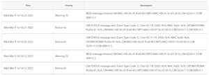

I had a tech from my ISP out earlier today, and he tested the line up to my modem and showed a very consitent 1200-1300 Mbps down. When he tested the speed wired to my CAX80 the test showed very poor speeds which is what makes me think the issue is with my CAX80.
That said, we live in a townhouse that is connected to 4 other townhouses so I'm unsure if there are splitters anywhere between the modem and ISP service box.
How would I go about dealing with the correct and un-correctables on channels 17 through 19? Is that something I need can do or would I need to call Comcast again?
Thanks in advance!
