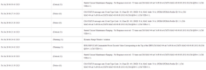

I was wondering if anyone can help me decipher these logs. The blinking lights and connection issues started recently, Same products and set up were fine for years. I do have a few splitters since it...

Please post a copy and paste of the modems connection status page.
https://kb.netgear.com/30007/How-do-I-obtain-the-cable-connection-information-from-a-NETGEAR-cable-modem-modem-router
Any Criticals, Errors or Warnings seen in the event logs needs to be reviewed and resolved by the ISP. Indicates a signal issue on the ISP line up to the modem. https://highspeed.tips/docsis-events/

| Hardware Version | 1.01 |
| Cable Firmware Version | V8.01.02 |
Currently the Router I am using is the Nighthawk XR1000
When I did go to the Cable Connection log it was showing Status poor which I will paste here but definitely going to start going through the action list as quick as I can. I don't have any splitters but there are some female to female extenders on the way (possibly 2) so not sure if that can cause issues.
- FURRYe38Jul 28, 2023Guru - Experienced User
Power levels are too low and below spec and need to be raised:
https://kb.netgear.com/24311/Power-level-guidelines-for-a-NETGEAR-cable-modem-router
You have correctables and un-correctables that should be Zero.
Have the ISP check the signal and line quality UP to the modem. Be sure the ISP provisions the modem correctly.
