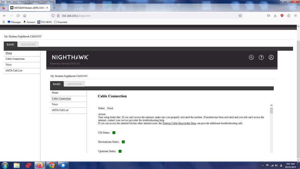

One last try since we asked about this before, Please post a copy and paste of the modems connection status and event log page.
https://kb.netgear.com/30007/How-do-I-obtain-the-cable-connection-information-from-a-NETGEAR-cable-modem-modem-router
https://kb.netgear.com/30008/How-do-I-view-or-clear-the-event-logs-on-my-NETGEAR-cable-modem-or-modem-router - db3058Oct 22, 2023Guide

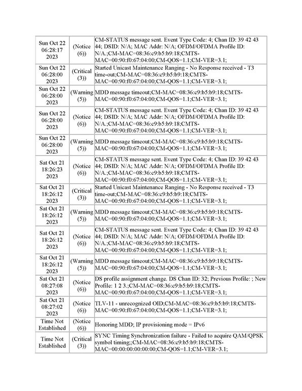

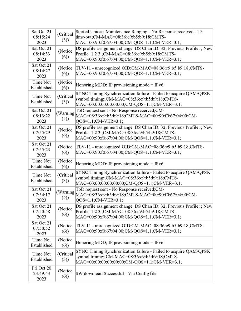

Attach the cable diagnostic text file. The details would be much more helpful. See attached.
- FURRYe38Oct 22, 2023Guru - Experienced User
Any Criticals, Errors or Warnings seen in the event logs needs to be reviewed and resolved by the ISP. Indicates a signal issue on the ISP line up to the modem. ISP are responsible for the signal up to the modem!

Here you go..thank you
Ok, so Correctables and Uncorrecables look ok but the power is fluxuation all over the place across all channels. Each channel needs to be with in 3db of each other. You have some channels that are just too high to some down around zero.

32 Not Locked Unknown 0 0 Hz 0.0 dBmV 0.0 dB 0 0You need to get a on-site tech out and have them take a dive in to there signal up to your modem. They need to review Any Criticals, Errors or Warnings seen in the event logs needs to be reviewed and resolved by the ISP. Indicates a signal issue on the ISP line up to the modem.
