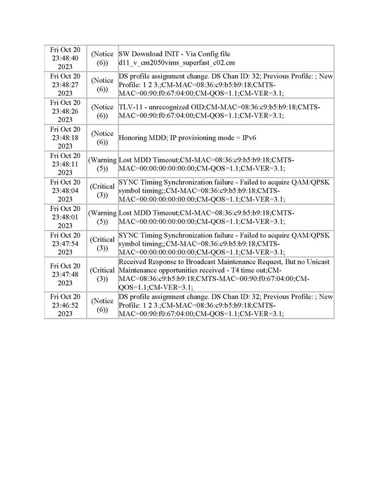

Nighthawk CM2050V Comcast Firmware Killed Speed
I understand Comcast has just updated the firmware in these routers from V2.01.03 to V9.01.01. My download speed went from 934 to 225. Comcast tech came out yesterday and cleared some signal loss b...

Any Criticals, Errors or Warnings seen in the event logs needs to be reviewed and resolved by the ISP. Indicates a signal issue on the ISP line up to the modem. ISP are responsible for the signal up to the modem!

The ISP specifically Comcast does not give a **bleep** about or want to see what the modem diagnostics are. They will troubleshoot their end with their cable analyzer, repair issues it reveals (in my case changing all the connectors) and they leave.
