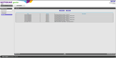

So basically talked to isp and they said i should be locked into all 32 channels and hes never seen this happen and told me to come here and ask for any answers?

Please post a copy and paste of the modems event log page.

- FURRYe38Apr 25, 2023Guru - Experienced User
Those criticals needs to be reviewed by the ISP and resolved. They indicate a signal line issue.
Be sure your using a good quality LAN cable between the modem and router. CAT6 is recommended.
What is the brand and model of the host wifi router connected to the modem?Have the ISP check the signal and line quality UP to the modem. Be sure the ISP provisions the modem correctly.
Be sure there are no coax cable line splitters in the between the modem and ISP service box.
Be sure your using good quality RG6 coax cable up to the modem.
Start with removing any amplifiers, signal attenuators, or splitters from the coax.
From there check the line for kinks, damage, moisture in the line.
Check the connectors for improperly made ends, foil touching the copper coax line, loose connections, bad/old/cheap connectors, or corroded connections. Replace them if you do.

https://highspeed.tips/docsis-events/Might try a different modem and see. The CM700 is getting up in age and maybe a newer generation maybe needed.
