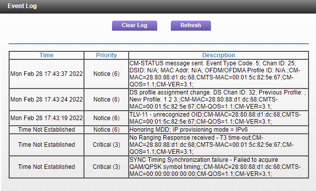

- rhosue21Feb 28, 2022Aspirant
Here is my latest event log.
- FURRYe38Feb 28, 2022Guru - Experienced User
Couple of criticle which the ISP should take a look into.
Again, all this depends on good signal from the ISP street box or line pole up to you home and to the modem. If anything is off inbetween, could cause problems here.
Other option would be to rent for a short period of time, one of there modems and see if you notice similar problems or not. If you do, then you'll know.
