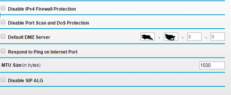

Opening Nat types for PS4 2017
I am trying to open my NAT type but I dont even have the option to change the type. I have followed the instructions but I dont have the option to change it. I followed the instructions @ https://k...
wmpooler
Mar 03, 2017Tutor
I guess I will have to play around with the dmz again, nothing else is working and this is unresolved.
- TheEtherMar 03, 2017Guru
