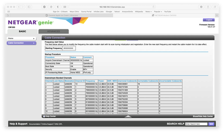

I've been experiencing intermittent internet connection issues since upgrading to a Halo mesh router about 1.5 months ago. Things were rought for about the first 1-2 weeks, and then suddenly corrrect...

Your power levels and errors are normal and within the optimal range.
Its when you get the uncorrectable errors you really want to worry.
whats more important is the logs. The cable connections page are just a snapshot. The logs give us more info.
