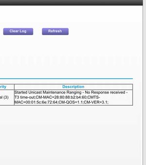

PLEASE HELP-CM1200 Modem event: Started Unicast Maintenance Ranging-No Response received

Please post a copy and paste of the modems connection status page.
Have the ISP check the signal and line quality UP to the modem. Be sure the ISP provisions the modem correctly.
Be sure there are no coax cable line splitters in the between the modem and ISP service box.
Be sure your using good quality RG6 coax cable up to the modem.
Be sure to power OFF the modem for 1 minute then back ON.
https://community.netgear.com/t5/Cable-Modems-Routers/General-info-and-Troubleshooting-for-Cable-Modems/m-p/1530376#M12853
https://highspeed.tips/docsis-events/

- FURRYe38Aug 29, 2021Guru - Experienced User
What happens if you uncheck the "Enable Extended Upstream Transmit Power"? Something I never had enabled on my CM1200.
- plemansAug 29, 2021Guru - Experienced User
do you have a splitter or signal attenuator you can add? your power levels are running hot.
- JasGr81Aug 29, 2021Aspirant
Yeah I do but I just took it out because everyone kept telling me I shouldn't have any splitters. Just a straight cable from Spectrum's box on the outside of my house to my cable modem. So I took the splitter out.
how big of a splitter?
Decent quality one?
Your power levels are high and that can cause errors/line issues.
If you try adding it back in or swapping it for a different one.
I'd shoot for at least a triple splitter.
