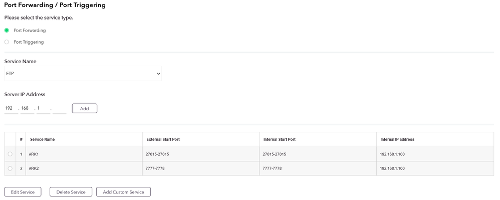

I will have to wait for the forum software to finish processing the images so that they can be visible to others. But in the mean time, if forwarding ports for the ark server, the settings would look like this.
(I embedded the i mage as well as attached it as a file since it takes a while for images to become visible after embedding)
Assuming default ports, you would forward ports 27015, as well as ports 7777-7778.The internal IP address will be the LAN IP of the PC running the server software. (Do not assign a PC that is LAN side, an IP that matches the WAN IP or you will not have any connectivity.
For example, if the LAN IP of the PC running the server is 192.168.1.100, then that is what will be on the internal IP address setting.PS, ARK's dedicated server software can often behave weird with the server browser when multiple systems on the same LAN try to access it, sometimes it will not show up in both, but if you use the console command to manually connect to the server. For example if it is 192.168.1.100, then in the console command window in ark, you will type the following command that I put in bold text.
open 192.168.1.100:7777If the device is on the WAN side of the network, e.g., a friend across town wants to connect, then they will do open WANIP:7777
For example, pretend that the WAN IP is 212.227.94.130
The person on the WAN side will type in open 212.227.94.130:7777
