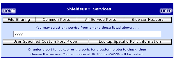

But a site that can tell you if a port is forwarded properly without a server active on it, is GRC shields up https://www.grc.com/shieldsup
Click on proceed, then type in port 7777 then click on the button that says "User specified custom port probe". if the port is forwarded but no service is detected running on it, then it will list it as closed, but if it is not forwarded, it will list it as "Stealth" (you can confirm this by trying a port outside of the range you forwarded as well as a port in the range)

GRC Port Authority Report created on UTC: 2024-07-05 at 00:54:55 Results from probe of port: 7777 0 Ports Open 1 Ports Closed 0 Ports Stealth --------------------- 1 Ports Tested THE PORT tested was found to be: CLOSED. TruStealth: FAILED - NOT all tested ports were STEALTH, - NO unsolicited packets were received, - NO Ping reply (ICMP Echo) was received. - WolfaJul 04, 2024Aspirant
I've tried it with the server running listening for those ports and i get the exact same response.

From the GRC report, it shows the port at closed, thus meaning that the port is forwarded but nothing is actively using it LAN side, thus that data is dropped.
If the port was not forwarded, it would be listed as stealth as the router would not react in any way to the probe, thus causing the probe to time out. In cases like that, something on the PC is stopping it from properly running the server.

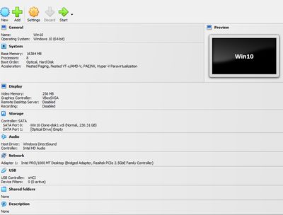

In cases like that one potential solution is to run the dedicated server in a virtual machine with the network access set to bridged. It also provides an extra layer of protection in case a server exploit is ever discovered and used, then potential harm would be limited. For example if using my main PC, I will sometimes use a windows virtual machine hosted in virtualbox https://www.virtualbox.org/ though in my case, I can run an ARK dedicated server locally. Though if doing that, I will sometimes need to disable PIA or at least the split tunnel function to avoid this error, unless I run it in a VM. - WolfaJul 04, 2024Aspirant

For a virtual machine, there are many options such as virtualbox. https://www.virtualbox.org/
Then you simple download a ISO of windows or any other OS you want, Microsoft allows you to download a copy of windows directly from them. For example, using the windows 10 installation media tool (which you use the option in the tool to download the ISO file for windows 10) https://www.microsoft.com/en-gb/software-download/windows10
Or the windows 11 ISO download (3rd option on the page): https://www.microsoft.com/en-us/software-download/windows11/
The way it works is you create a virtual machine, and then decide on how many CPU cores and how much RAM you would like to allocate to it. Only challenge is running it on a laptop can get tricky if it doesn't have much RAM, since a VM will essentially be doubling the operating system overhead since you are running a second copy of windows as an application.
For me, since I run it on a desktop system, I allocate 8 cores along with 16GB of RAM to it.Then I have the network driver for virtualbox set to bridged. This makes the VM look like a separate physical system on the network, and also get around any port issues from the VPN split tunnel.
In terms of CPU performance, there is very little overhead if you have the hardware virtualization turned on in the bios, (most laptops will have it on be default). Overall a VM is useful if you want an OS environment tailored specifically to a server you want to run. They are also useful for their snapshot function which allows you to restore it to the condition in the snapshot, which is great for testing random software without risking the main OS, (though the VM will not run software properly that requires GPU acceleration, thus while game servers can run, games themself will not run. (the emulated GPU is slower than what is found in most modern mid range smartphones).

got the VM running / ASM downloaded and installed with SteamCMD ... set the server up and network to bridged. Port Forwarded the VM and started the server. Same issue, still couldn't connect and it couldn't find the server.
