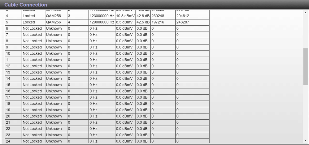

- hugsss_2000Aug 18, 2022Aspirant
can you direct me where to find the connection status page?
- FURRYe38Aug 18, 2022Guru - Experienced User
1. Launch a web browser from a computer or mobile device that is connected to the
modem router network.
2. Enter http://routerlogin.net or http://192.168.0.1.
A login window opens.
3. Enter the modem router user name and password.
The user name is admin. The default password is password. The user name and
password are case-sensitive.
The BASIC Home page displays.
4. Select Cable Connection.- hugsss_2000Aug 18, 2022Aspirant
