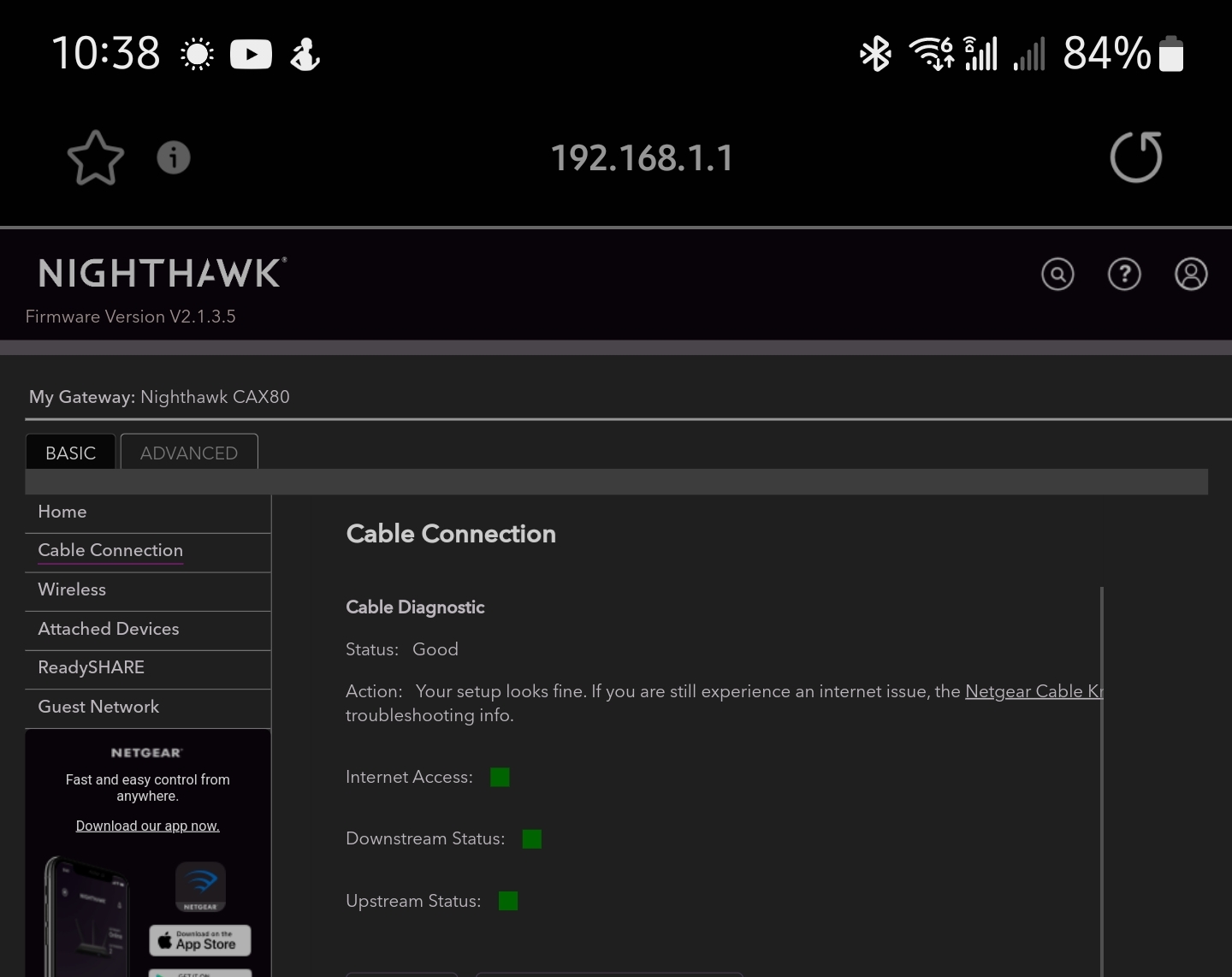

Mellojosh
Mar 25, 2022Star
WTF, the cable connection page is irrelevant. The multigig port fails on the LAN not the WAN. The multigig port fails even if I remove the COAX cable and use the CAX80 as a router only with no internet connection. I'm going to go ahead and post the status screen, but I want to stress the issue is with the multigig port with wireless radios enabled.
