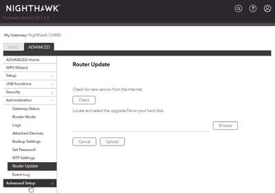

Needless to say, my unit received the automatic update once again last night and as the result, it screwed up all port forwarding.
I try to find the automatic update option but I cannot find it. Is there any other secret menu option that I can enable to turn it off (like the developer mode on Android phone, for instance)?
- KitsapOct 03, 2024Master
GearNet7 wrote:Needless to say, my unit received the automatic update once again last night and as the result, it screwed up all port forwarding.
I do not have a CAX80 available to check on the specific page. Maybe FURRYe38 can shed some light on this question. There is also a chance that option has been depreciated in the most recent firmware release.
